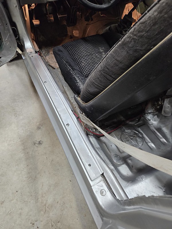

I swapped out the original passenger side glass yesterday with the new one I recently got. I have to say after doing so multiple times, I have that process down pat. I can now do a window swap in about 10 minutes :grin:

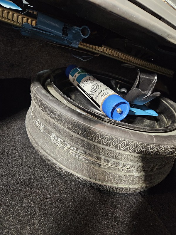

I was surprised and happy to see the bracket in place to hold the jack into place. Rusty in this picture but I have taken it out and painted.

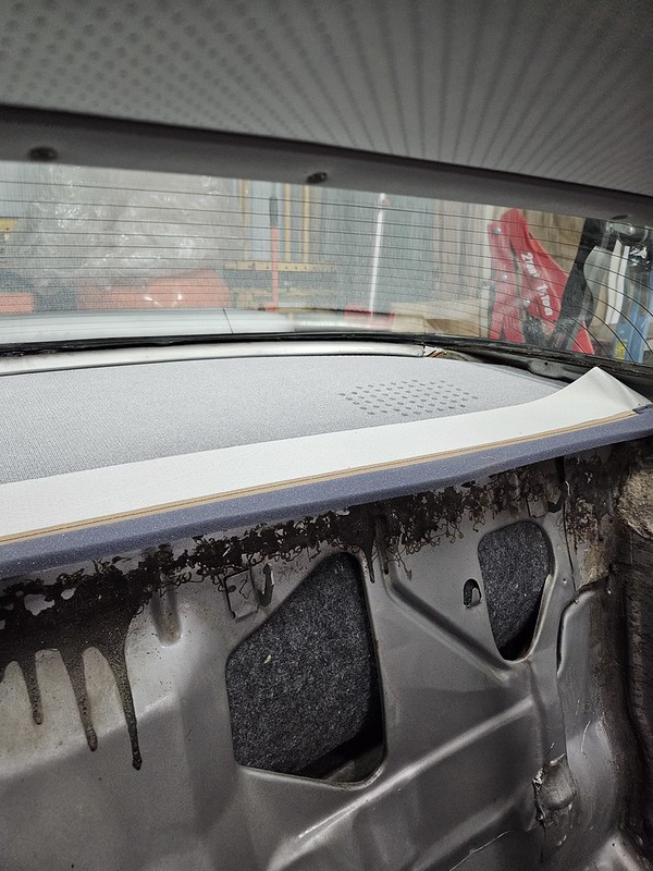

I got a few things put into place this morning including new rear deck trim temp installed, sill wire covers, door weatherstrip, jack in place and trunk buttoned up again. Also cleaned up the interior trim that I dyed a couple of years ago, had to touch up a couple of pieces and had to dye a rear side panel.
20250308_125323 by Kerry Grubb, on Flickr20250308_140926 by Kerry Grubb, on Flickr20250308_123017 by Kerry Grubb, on Flickr20250308_141225 by Kerry Grubb, on Flickr20250308_115438 by Kerry Grubb, on Flickr20250308_120440 by Kerry Grubb, on Flickr20250308_135553 by Kerry Grubb, on Flickr20250308_122018 by Kerry Grubb, on Flickr20250308_140654 by Kerry Grubb, on Flickr

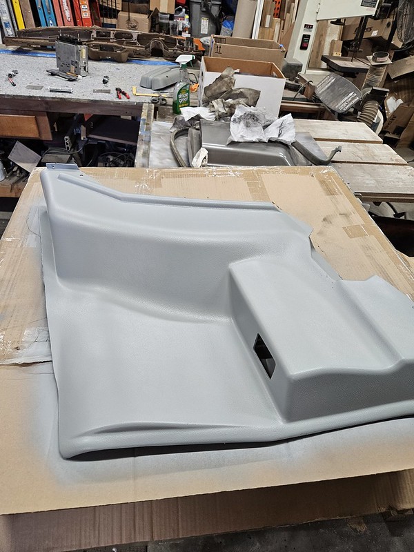

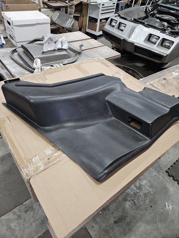

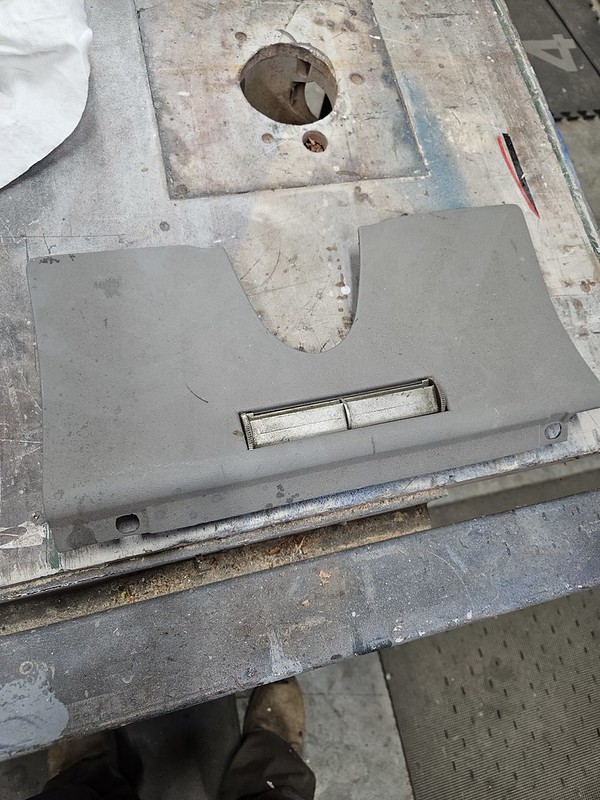

Working on int. trim, I retrieved my console from the other garage. Its been sitting there for a couple of years now since I did a rebuild. As a reminder it was literally broke in half. I was going to throw it away but decided to try and salvage for to save a few bucks. I was surprised that it had a couple of cracks :shock: where I made the repairs. I am not sure why. I ground out the cracks put some filler in reinforced with fibreglass tape, sanded with 60 gr then 120 gr then touch up with 220 gr. Using all SEM products, I primed, textured, primed again and colour coat. It came out pretty good, again :???: Found my ashtray, it is surprisingly nice on the outside, inside has a bit of rust so its now sitting with rust removal gel. Same thing with my shifter boot metal ring. It was pretty rusty so it will need a little work.
20250313_094853 by Kerry Grubb, on Flickr
20250313_094910 by Kerry Grubb, on Flickr20250313_150023 by Kerry Grubb, on Flickr20250315_124710 by Kerry Grubb, on Flickr20250315_141612 by Kerry Grubb, on Flickr20250315_144637 by Kerry Grubb, on Flickr20250315_144633 by Kerry Grubb, on Flickr20250315_140524 by Kerry Grubb, on Flickr20250315_141829 by Kerry Grubb, on Flickr
