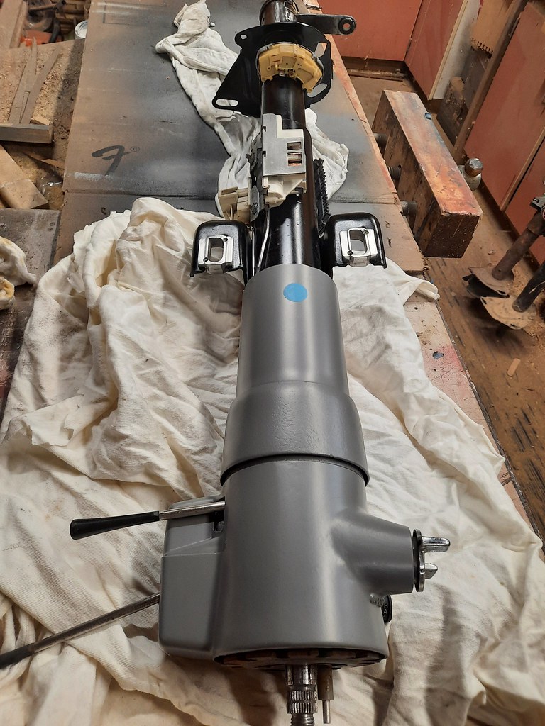

Re did the collar. Stripped off the old with my trusty little battery die grinder and a medium then fine roloc. Took all of 10 minuts. Then I put the collar on my shop furnace for a few minutes to warm it up. Sprayed with VHT wrinkle paint. I have to say it even impressed me. Came out darn near perfect. THEN, I put some colour to it with SEM  :( :( The SEM melted off the wrinkle coat. Strip it back down, wrinkle coat again, this time some rustoleum primer and then the SEM. Worked the second time around with primer, but the extra layer of paint concealed the wrinkles a bit. SO, I am thinking third times a charm.

Nice work Kerry! That steering column looks brand new and the collar looks great.

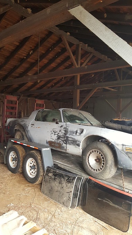

I realized since the reboot I didnt have any pics of the car itself so I will post some up here. From it being a barn find (not actually, just stored in a barn temp until I got it home to my shop) through the present. Not nec. in order
