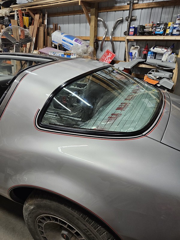

I have found that the roll striping does not like to go around bends too tight off the roll. So I cut a piece to length then slice it down the middle. It does stretch fairly well, I put the black on then the red. After the black was on I pulled the top protective layer off so to not interfere with the red stripe.
20250405_132530 by Kerry Grubb, on Flickr20250405_132717 by Kerry Grubb, on Flickr20250405_132847 by Kerry Grubb, on Flickr20250405_133319 by Kerry Grubb, on Flickr20250405_133455 by Kerry Grubb, on Flickr
Mark the same measurement on the dr side so they will be somewhat uniform from side to side and repeat the first few steps.
20250405_134049 by Kerry Grubb, on Flickr20250405_134423 by Kerry Grubb, on Flickr20250405_140116 by Kerry Grubb, on Flickr20250405_140718 by Kerry Grubb, on Flickr20250405_140727 by Kerry Grubb, on Flickr
Finished the way its supposed to be :grin: I will rest better now, LOL.

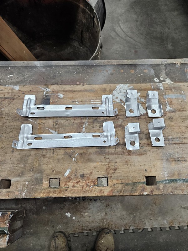

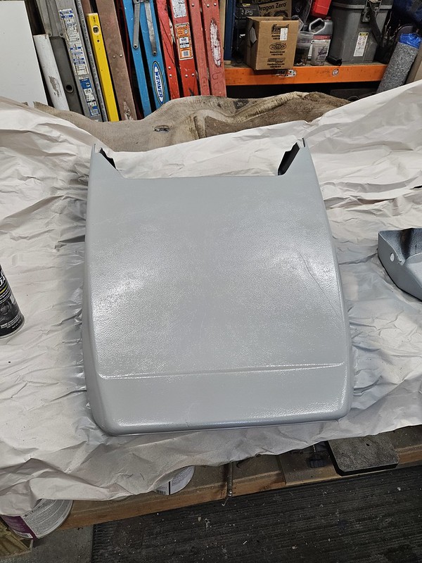

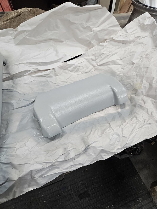

I got the pass back upright frame cleaned and painted. Its ready to go, need to get some hog rings. Cleaned and painted the back and the lower plastic panel.
20250412_121043 by Kerry Grubb, on Flickr20250412_153015 by Kerry Grubb, on Flickr20250412_152257 by Kerry Grubb, on Flickr20250412_153001 by Kerry Grubb, on Flickr20250412_153007 by Kerry Grubb, on Flickr
When I did my 77 I sent these parts out to be blasted and powder coated. They came back great but once the seat is no will EVER see anything. Its not worth the expense and the time for a 'perfect' part as far as this one is concerned. This will suffice as is.
