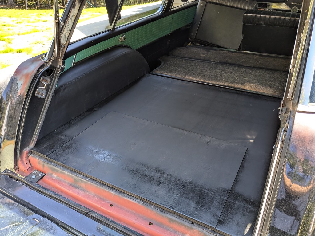

While my father-in-law was here we decided to tackle the rear wood floor for the wagon. I found a template online and we got to work.
I got busy and didn't take many pictures of the during process, but here's how it turned out. I'm very happy with how it turned out.
Looks great, but really highlights the need for me to replace the carpet pieces on the upper and lower seats. The carpet kit I bought came with those pieces just need to find the time to replace them.

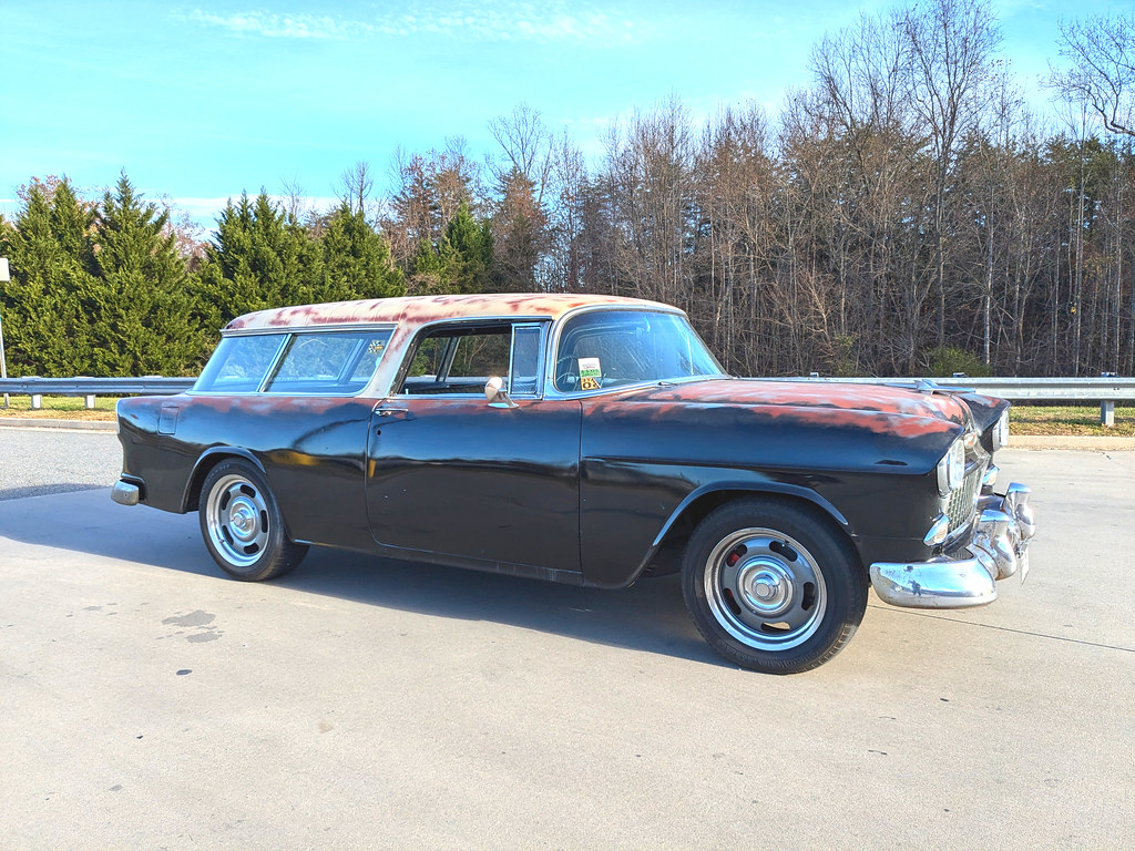

If only there was a side photo to show the stance...... lol

I only took it out once afterwards on my lunch break and haven't had it out since. Right now it likely has a "Carolina Lean" because it's higher in the front than the back. Once I get the drop spindles installed it should have a pretty killer stance.

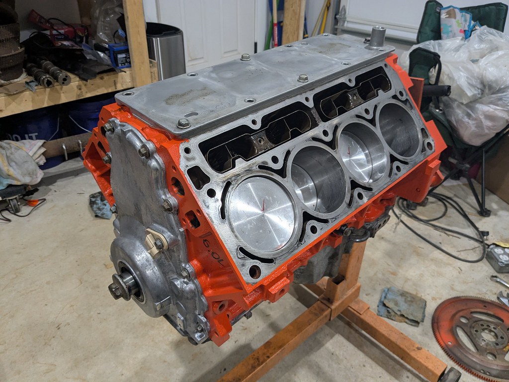

I didn't have many bites on the ported LS1 heads, but had in the listing that I'd trade for LS parts. One guy offered to trade me a 6.0 for the ported heads plus a few extra parts (stock push rods, yellow valve springs, valley cover and LS1 rockers) that I was going to use. After talking with him more, he ended up giving me a single 823 head and a TBSS intake w/ TB too! Done deal, made that happen and got it back home. My youngest son had an absolute blast helping me tear it down and inspect. It had one bad piston with some scoring. After I got it torn down we also found that it needs cam bearings. I got the bad piston out and then used my dingleball and the scoring isn't very deep at all and would probably be good to send. I'm probably going to get a new piston put a cylinder head on and do a compression test to see what it looks like.
Bearings look good and the other cylinder walls cleaned up very nicely.
No idea what I'm going to do with the engine right now, but I'll try to collect parts to put this engine together. Maybe I'll pick up another project or roller and swap it into.

Once that sold, I decided to pull the trigger on a Quick Performance 9" rear. I ordered it with 35 spline axles and the GM flush mount ends so that I can run the tried and true LS1 rear brakes. Hopefully it will be shipped in the next few weeks. I'm going to order an assembled unit through Speedway once I get the word on shipping the housing and axles. I also ordered a pair of new drop springs from Real Deal Steel because the spring on the passenger side is almost flat. It will likely raise my ride height because of how worn the stock springs are, but I'll run a drop block to get it back to where it is now. They shipped just like this with no box. I was a little surprised, but they seem to have made it safely. We'll see once I open them.
I also grabbed a few fuel fittings that I needed to run the Dorman LS2 intake. One is made by Fragola for fuel rails. It's a -8 ORB on one side, then 90* to 3/8" GM quick connect on the other side to connect to my Nylon fuel lines. I'll need to tap into the lines I ran though to add the flex fuel sensor as well.
I was checking Facebook marketplace this weekend as I usually do and came across a guy selling an upgraded CTSV fuel pump and Vaporworx fuel module for a great price. I only needed the fuel module, but bought it all because I knew that I could either use the pump or sell. The guy was selling because he was going to the next level with his G8 and swapping to a 416 stroker with Kong 2650 which will require a triple pump setup. Good news for me, because that was the last piece to my fuel puzzle and one step closer to Turbo Time.
I'm trying to keep the car drivable as long as I can, so I haven't torn into it yet. In the short term I want to get the inner fenders repaired, so that I can install them and move the battery from the firewall to the driver's side core support. I want to give more room for the post turbo exhaust and more room around the valve covers. I'll also be putting the A2W intercooler on the passengers side down low, so I want to keep that side clear. Once I have all the components for the 9", I'll also need to measure for a new driveshaft from PEM. It will be nice once the new rear and upgraded driveshaft are installed so I shouldn't have to worry about breaking the rear!
