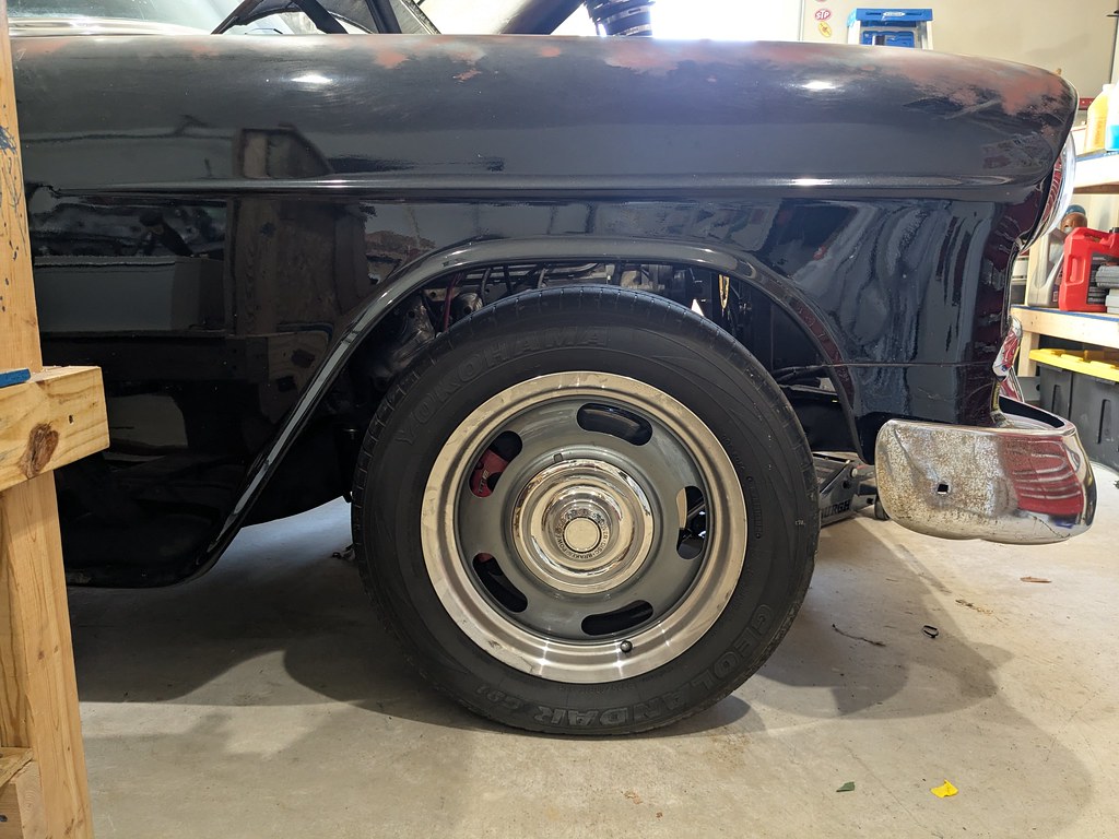

It's been a while since I've been back into the swing of things and got some work done to the car. I've been collecting parts, buying/selling, house projects and etc, but now I want to get back to the car and ready for some warm weather cruising. There are several things with the front end that I want to address, but first up was the stance. I installed the CPP C5 2" Drop springs and tubular control arms last fall, but after I got them installed it seemed to be no change in the stance. I think with the isolator cups in the bottom of the lower control arms it acted as a spring spacer to offset the gain from the 2" drop spindles. I opted to cut one coil off of the springs to hopefully stiffen the front end slightly and get a lower stance.
Initial measurement was 28" left and right.
Got it back together and the drop was about 1.5"
Before:
After:
It's hard to say how much it will change until I get it outside, but it is noticeably lower.

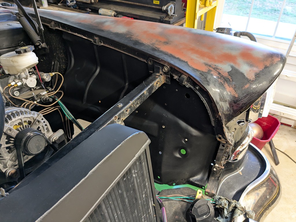

Next up was getting my original inner fenders installed. I didn't get any pictures, but I repaired the lip and some pin holes on the lower sections. Got them prepped and repainted with SEM Trim Black to match the firewall.
Started with some disassembly
Only a handful of hardware held on the front grill. We'll be changing that!
After struggling a bit to get it installed, I needed to remove the lower bolt down by the rocker to allow the fender to swing out. That gave me enough room to get the upper side into place. After wrestling with the fender a bit, I finally got a few screws in place. I also installed some original fender brackets I picked up that were powder coated and came with some original zinc coated hardware.
Took some time to clean up the core support and repaint, then installed some new aftermarket filler panels that I picked up several months ago. I painted them flat black, but it doesn't quite match the sheen of the Trim Black which I ran out of. I'll touch it up though before I button everything back up once I get a new can.
I notched the passenger's side where the transmission cooler lines go. Used a hole saw to get the radius and my tin snips to get the straight lines.
I ran out of the package of screws that I bought for this project so it's not final, but so far it looks way better than it did before. Inner fenders and new filler panels make a huge difference.
The I turned my attention to the front lower valance panel. I didn't pay much attention before, but the back is in pretty poor shape. I'm going to attempt to repair it, but may just pick up a new one when I'm at Spring Carlisle next month.
That's where I left the car a few days ago, but much more work will be done to clean up the engine bay. I was also able to snag some more key parts that will be very helpful with the next stage of my build. First up is a Mighty Mouse catch can. It's got the fittings for boost already installed, just need to buy or make a bracket for it to be installed.
