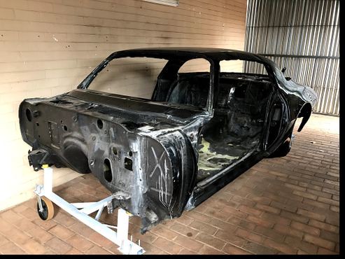

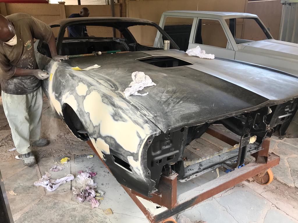

Then repairs began
Those that remember the old thread will know I had a lot of issues during this stage of the resto. I can't even remember all of it, so I'm not going to try and type it all up.
Here is some of the work

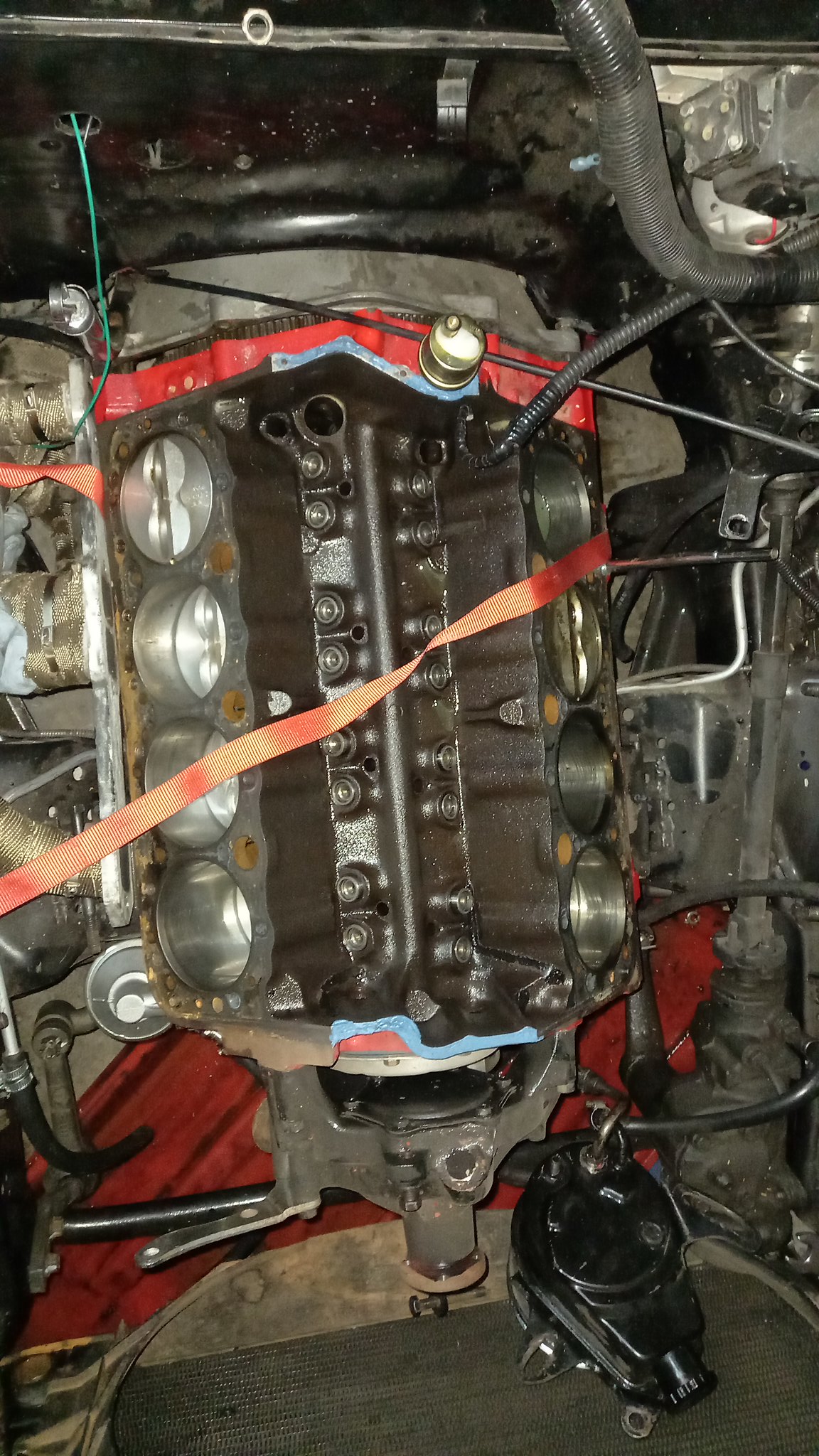

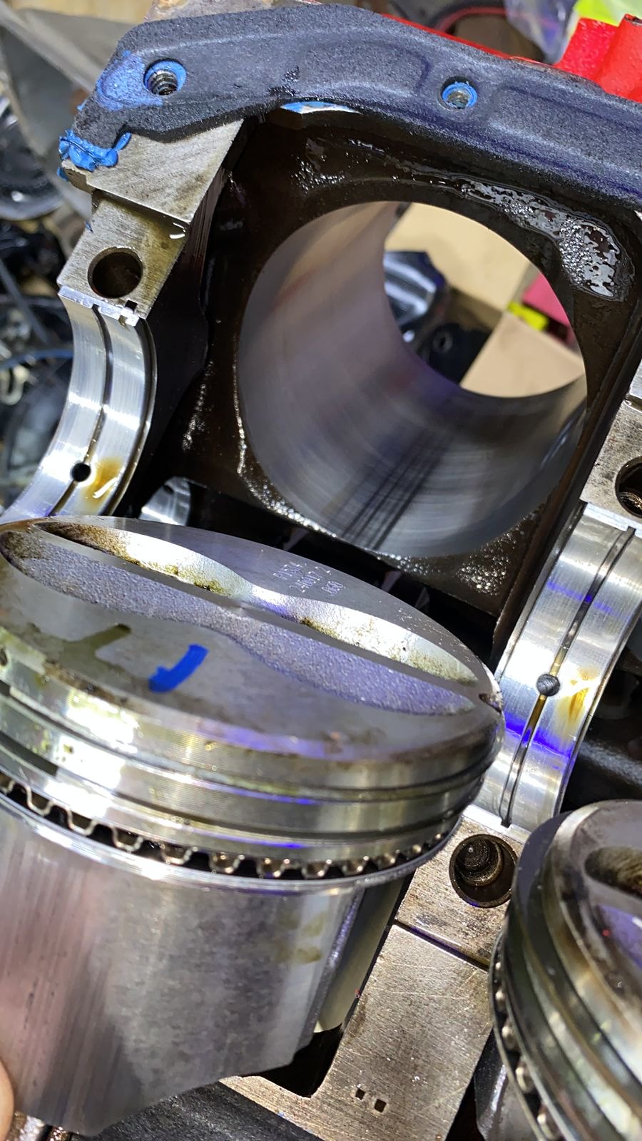

In the meantime I had rebuilt the engine and gearbox myself.
I also had to get a new front and rear bumper made is fibreglass. This caused endless delays and empty promises.

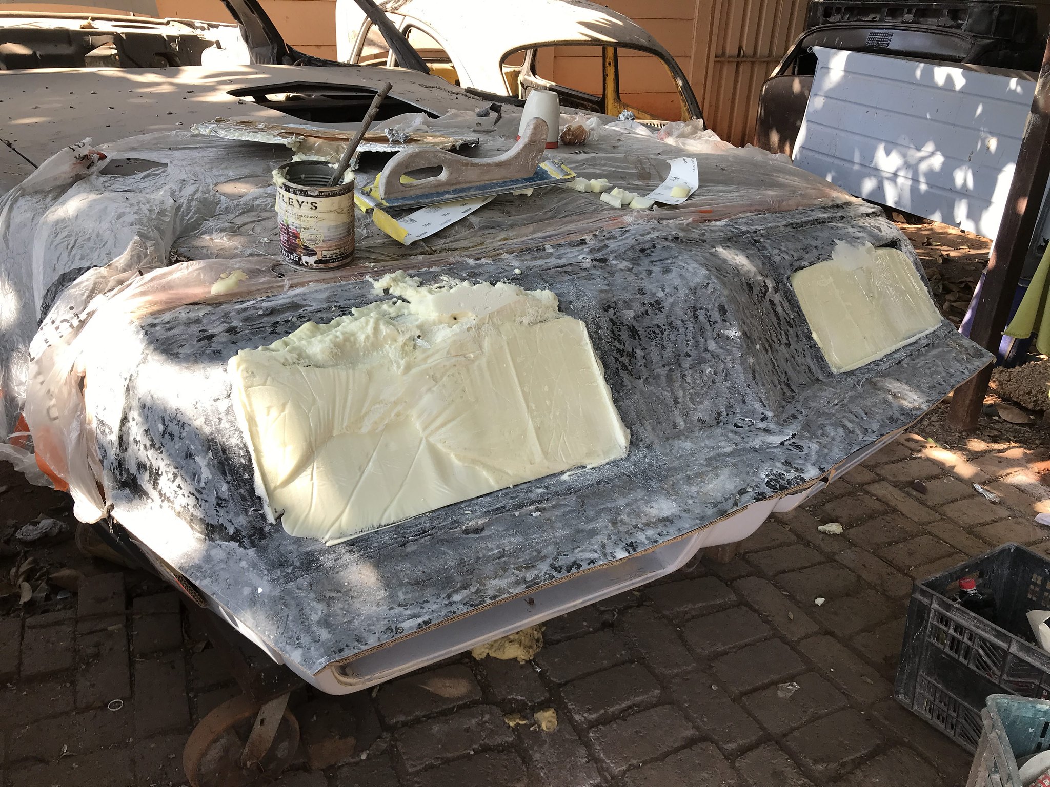

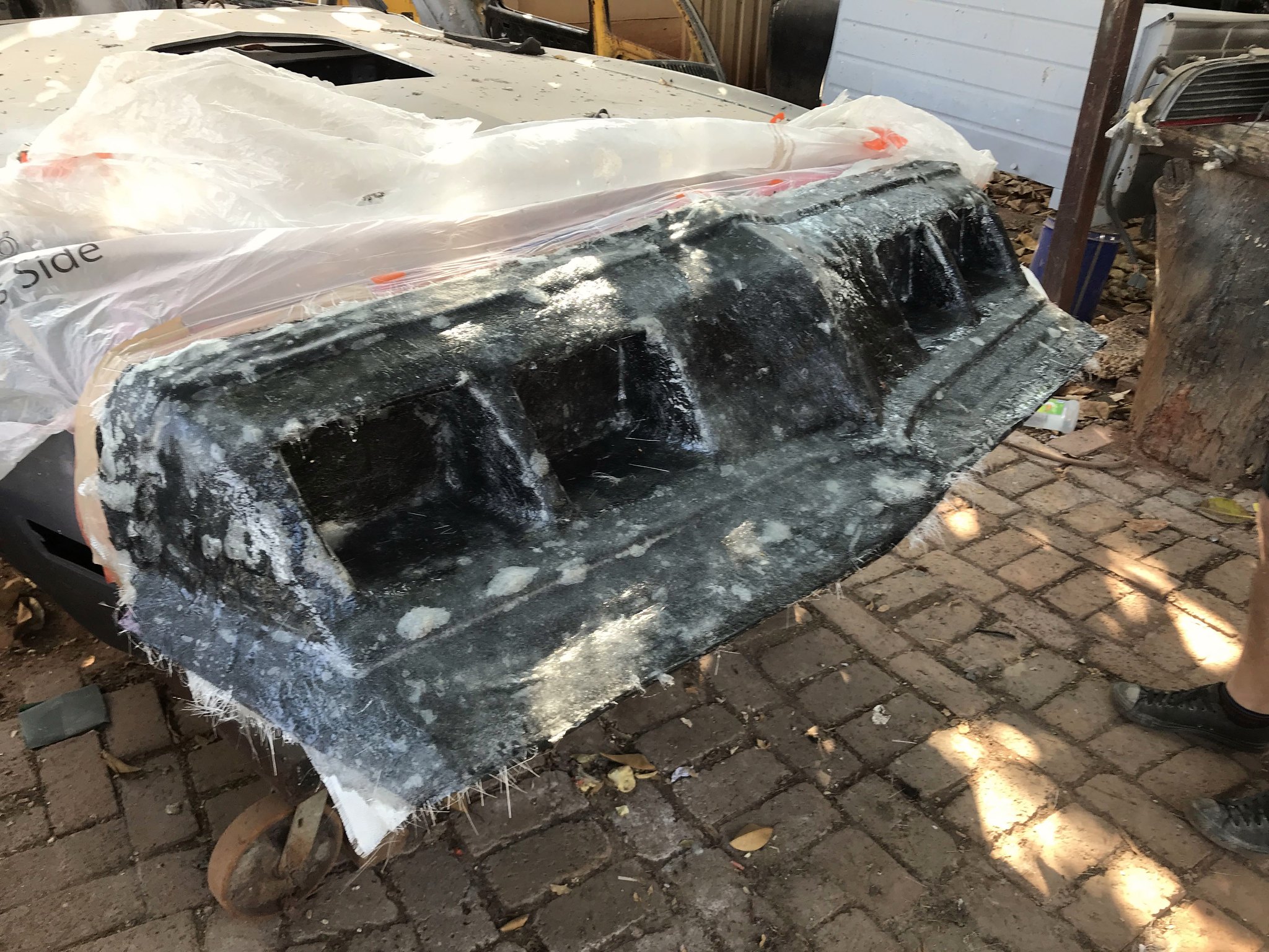

Some time in 2019 I ended up making the nose myself. With the help from the builder/painter

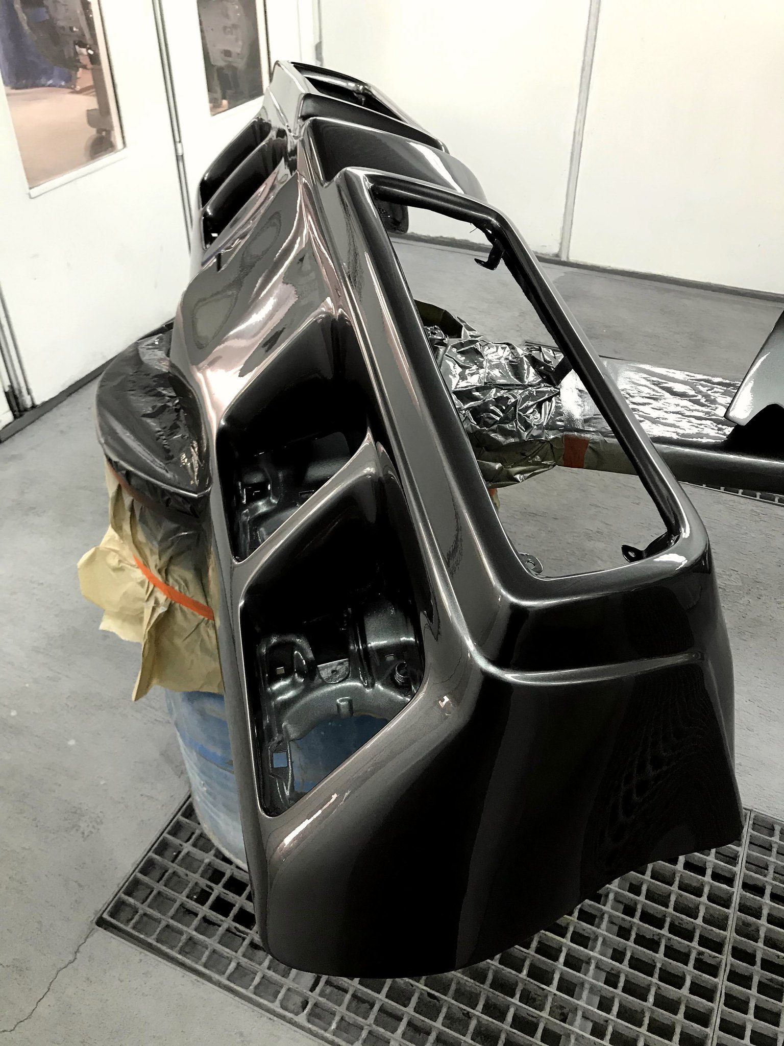

Then came Covid-19 and we were in lockdown.
Eventually in the last half of 2020, I moved the car to another shop.
It then got to paint!

IMG-20210825-WA0010 by DeVilliers Buys, on Flickr
IMG-20210831-WA0012 by DeVilliers Buys, on Flickr
IMG-20210831-WA0016 by DeVilliers Buys, on Flickr
The last picture says it all.
I had water in no 6, so originally a though the head gasket may have gone, so I opened it up. Had the head pressure tested, nothing wrong. Head gasket showed a perfect seal. So I started digging further. Took of the other side and noticed a little water as well on no7. This told me the block must be the problem.
Long story short, engineering was shoddy work, and the .60 oversize was bored skew on one side. 1,3,5,7 totally destroyed.  This caused the block to crack, so it's a paper weight.
Still searching for a replacement block and waiting for the engineering shop to tell me what they are going to do about this.
I'm livid, to say the least.
Anyway, onwards and forwards. I'm tired of this money pit.

« Reply #28 on: September 03, 2021, 09:06:43 AM »
After all the hard work and money this is the last thing anyone would want to deal with. My heart goes out to you!
In the US small block Chevy parts are cheap and plentiful, from what you have said in the past parts in your part of the world are expensive and shipping is crazy.
I don't have any good advice other than to step back for a little bit before making any major decisions. Your car is beautiful it just needs a new heart.

Apologies for the late reply.
Post 4 above, tells a little bit of the story. I myself, was messed around for the better part of a year with people promising they can make the nose and then not delivering.
The mould was made in 2 parts. Top and bottom and then stitched back together.
The nose was fitted, and covered in release agent. Fibre glass was then laid over. The bendy bits were filled in with an expanding foam to keep it from collapsing. The this yet, rigid fibreglass was pulled of and laid in a cardboard outer shell. It was then filled with expanding foam between the mould and cardboard. This was done to keep the shape rigid then making the bumper.
Same was repeated for the bottom half.
Then it was just laying your fibreglass and resin.
The two halves were trimmed and fitted, and then joined together with more fibreglass.
Very very amateur style :)
