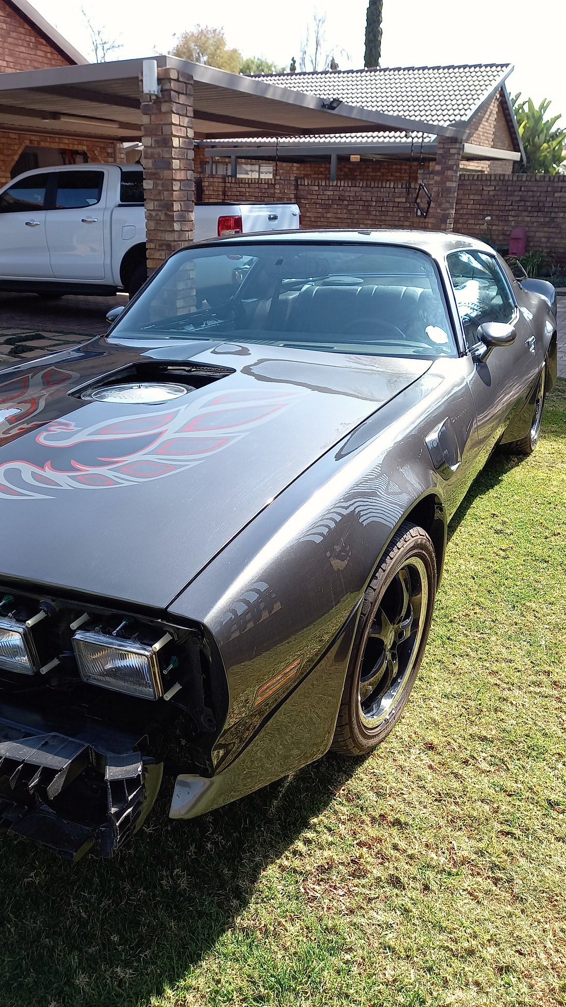

« Reply #65 on: August 29, 2022, 02:00:20 AM »
It's on!
IMG-20220827-WA0000 by DeVilliers Buys, on Flickr
Just look as that badge!
20220827_131619 by DeVilliers Buys, on Flickr
« Last Edit: August 29, 2022, 04:41:33 AM by DeVilliers »

Re: 1979 Trans-Am Restoration - South Africa (Reboot)
« Reply #66 on: August 29, 2022, 04:28:37 AM »
Looking good.
« Reply #67 on: August 29, 2022, 08:41:07 AM »
New nose looks great!

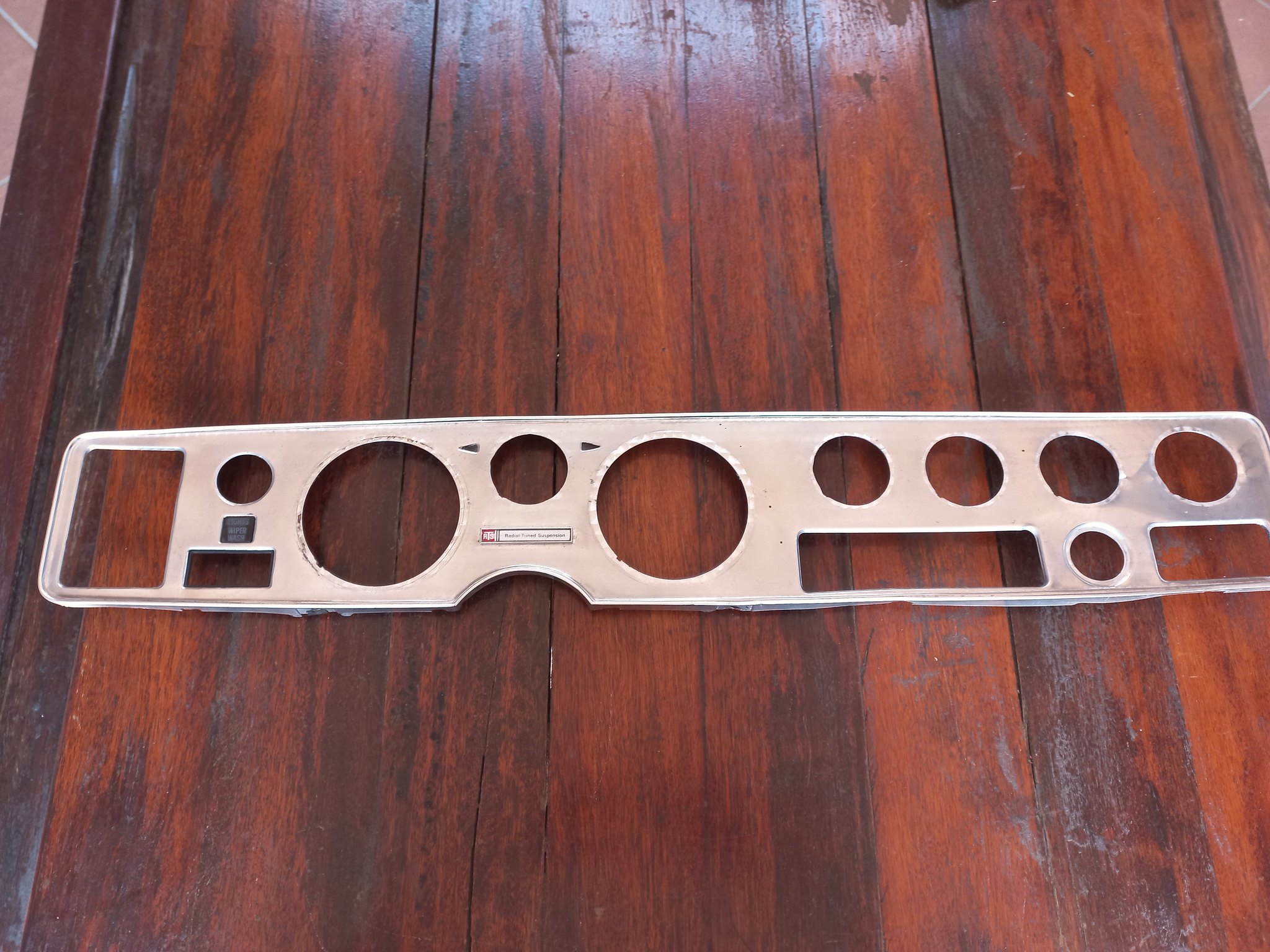

When I got the car the original gauge cluster was long gone, and the previous owner has some nasty auto gauges stuck directly to the bezel  :(
So waaaaaayyyyyy back, when all this started, I imported this kit.
https://www.intellitronix.com/product-page/firebird-70-81-led-replacement-gauge-panel
The kit was installed long ago, so I can't remember if there was a pic on the old thread.
2021-08-02_10-33-22 by DeVilliers Buys, on Flickr
This was all I had of the original bezel (after a clean):
2022-10-14_09-57-19 by DeVilliers Buys, on Flickr
I managed to find a set of original bezel rings on eBay and some other bits. A lick of paint, and I got back to this:
2022-10-14_09-58-09 by DeVilliers Buys, on Flickr

Got the scoop installed. Ended up making a bracket to fit the air cleaner. need so final touches, but it seems to be working. It's not functional, unfortunately.
2022-11-21_09-54-58 by DeVilliers Buys, on Flickr
2022-11-21_09-55-36 by DeVilliers Buys, on Flickr
