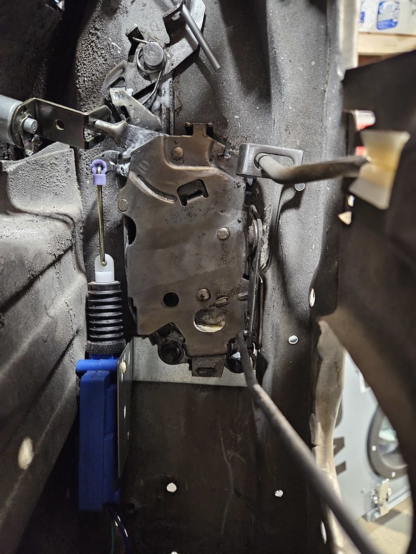

I got the pass side door finished up. Window installed and working. I jumped the power off of my battery charger as the switch is not hooked up yet. I bought some relays and want to go that route along with a new switch. I took the dr. side door insides apart today for their time on the bench. Started the rust removal soak and clean up of the tracks. I bought new window hardware years ago and it took a bit of digging but I did find it. I searched everywhere for the special tool to remove the window parts with no luck. Came back into the office and there it was behind my desk. Since I know what Im doing this time around I went ahead and drilled out the inside handle and the old power door lock motor. I have all of the rebuild parts and hope to get this door finished in a week or two.
20250202_151438 by Kerry Grubb, on Flickr20250202_154101 by Kerry Grubb, on Flickr20250202_154142 by Kerry Grubb, on Flickr20250202_163627 by Kerry Grubb, on Flickr20250202_155014 by Kerry Grubb, on Flickr

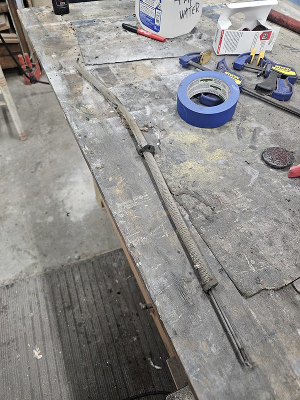

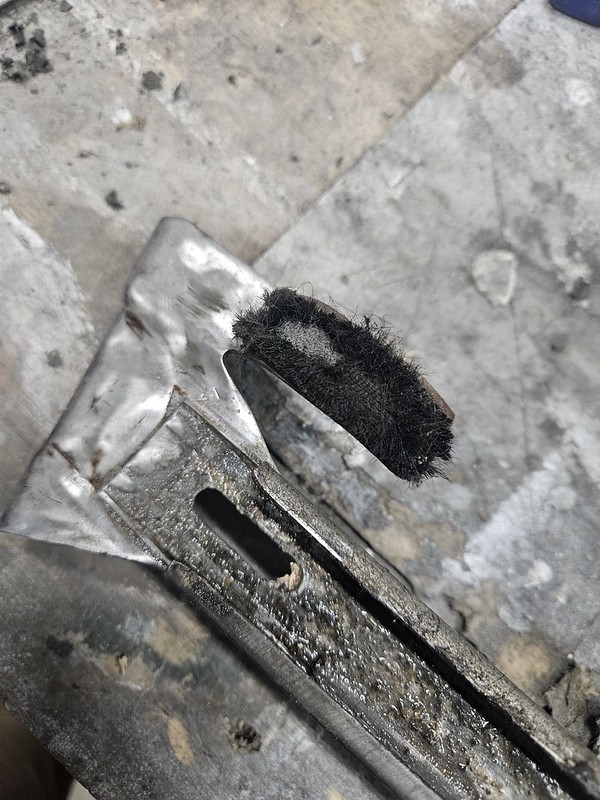

20250210_150221 by Kerry Grubb, on Flickr20250210_150238 by Kerry Grubb, on Flickr
It was hard to take a pic of the scratches, but the 'buff' marks are the main reason why I am replacing. There are a couple more long scratches as well.
20250208_134900 by Kerry Grubb, on Flickr20250210_150150 by Kerry Grubb, on Flickr20250208_121450 by Kerry Grubb, on Flickr20250208_125557 by Kerry Grubb, on Flickr20250208_131148 by Kerry Grubb, on Flickr
Anyone that wonders why their original windows may be slow, the gunk build up is horrible and the grease solidifies!
20250208_132038 by Kerry Grubb, on Flickr20250208_132436 by Kerry Grubb, on Flickr
Door latch rod cleaned up with new sound deadening sleeve.
20250208_123831 by Kerry Grubb, on Flickr
Rub pad that needs replaced.
