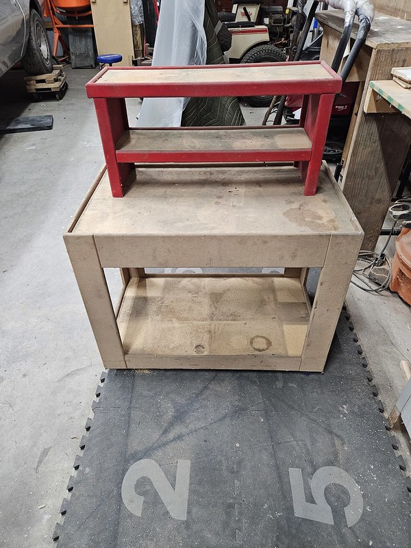

I built this cart during covid as a shop cart as I didnt want to spend any money on one. It has served me well and I will repurpose it for something. Lowes had this shop cart on sale, I have been looking at it for quite some time so I decided to bite the bullet and bought it. Early Christmas present.
20241124_094814 by Kerry Grubb, on Flickr20241124_094856 by Kerry Grubb, on Flickr
