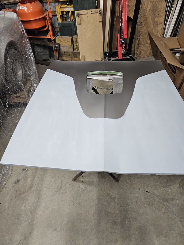

I set the hood in place one last time before painting. I had it placed before but the nose was not on. I wanted to make sure things lined up ok with that as well before a finish coat. Since I will be spraying a foot away from the finished car I bought a disposable car cover from Griots for $10. Car fits fine and there is plenty of room around it. I hope it keeps overspray off :shock:
Got the bottom of the hood sanded, one cleaning and started to tape off getting ready to spray. Hoping to get some colour on by the end of the weekend.

I started early in the morning, at least for me on a Sunday. About 9 am. Got the underside painted, let it sit for a few then clear coat. I let that sit for a couple of hours (got some game time in :grin:) then started the top side. First template in place to paint the dark grey. Then after that sat for awhile, maybe an hour put on the second template for the silver. I had to put several coats of that on for good coverage. Then when I thought it was good, there were some streaks I wasnt happy with so yet another coat. Silver seems to be a pain to paint and get it even. Let that sit for half hour, remove the template. There was a slight hard edge at the juncture between the two colours so I carefully cut it off with a razor, then some 400 gr sanding at that point only. Clean up again and clear coat. All came out ok, I will need to wet sand and buff. I am a bit rough shod painting and did not set up any kind of booth this time, I had one small bug get into the clear as it was dark when I got to that stage. It will buff out though. I finished everything up around 830 pm. It was a long day.
20241013_120846 by Kerry Grubb, on Flickr20241013_164858 by Kerry Grubb, on Flickr20241013_170305 by Kerry Grubb, on Flickr20241013_180911 by Kerry Grubb, on Flickr20241013_183225 by Kerry Grubb, on Flickr20241013_194757 by Kerry Grubb, on Flickr20241013_201535 by Kerry Grubb, on Flickr20241013_201541 by Kerry Grubb, on Flickr

Painting my shaker at the same time I ran into an adhesion problem after the second coat of paint went on. So I stopped with that. Not sure what the problem was. Maybe not clean, or a reaction with the prep sol seaping into a microscopic crack in the fibreglass? Anyway I sanded it down and will try to get it painted this evening.
20241013_184507 by Kerry Grubb, on Flickr
Also, the underside of the hood should be a semi black, but I gave it my spin on what Pontiac should have done with a special car. I think the silver looks more finished!

Tried painting again last night but I ran into the same problem, different area after a couple of coats of grey. So this morning before I left for work I sanded the whole thing down 1 more time :? I was using some Spray Way all purpose cleaner as a prep solvent and I figure it was not completely dry in the spot where the paint boofed! So, getting home from work early enough this afternoon I figured I would try again. This time NO cleaner. Just a couple of good wipedowns with a clean cloth. Paint went on fine, did about 4 light coats waiting about 10 between. Then I let it sit for 15 min and started the clear. 2 good coats with a 15 minute wait period between coats. All in all it looks pretty decent. Again, a few specs of dust but that should all buff out. I think I am finally finished painting this car!!

Started wet sanding yesterday. The shiny areas are the wet spots not dry yet.
So I made a couple of mistakes. First was I waited a week to start the 'cut and buff'. I went back to the paint shop for some more clear coat and the guys there told me that 24 hrs is a good enough wait time. They said the longer the clear sits the harder it gets thus, wet sanding is harder to do.
The reason I was getting more clear is that I boofed the wet sanding. I was too lazy! I started with 600, then 800 then 1200 then 2500. I then started buffing. This was all done in about an hours time!!! Problem was I never got the 600 gr scratches out. No amount of buffing is going to remove scratches that deep. So I scuffed the entire hood with 600 again (after cleaning well with grease and wax remover) then put an additional 3 coats of clear. The second go round had a little more dust than the first time as I was rushing it.
I waited the 24 hrs and started the wet sand with 2000 (as opposed to 600, which the shop said was way to coarse to start with) this time around. Took about 3 hrs to do the entire hood, still need a bit of touch up. Next up is 3000. I will do that tonight after work. I may stop at 4000 then start buffing.

Wet sanding started at 2000. I spent about 3 1/2 hrs at that grit. I got all of the orange peel out and a couple of bad spots. Surface was completely smooth. I run a small bar of rubber as a squeegee which reveals anything ugly. Then 2500 and 3000. I spent maybe an hour and half on these 2. My local shop has a product called Presta. Colour coded with matching pads. I started with the 'cutting compound' which is labled black with a black wool pad. Next was a polish compound which used a blue foam pad. The above pictures are the result of that process. This was done with a rotary 8" buffer. The fellow at the shop told me to finish up with my 6" Griots buffer and a Griots fine polishing compound. That will be done with a yellow foam pad. I plan on hitting that this evening.
As the hood sits, I think its about as good as the rest of the car. Depending on how the Griots stuff works out I may go back and buff the rest of the car. I cannot do any kind of wax until the decals are complete.
For those of you that wonder why a paint job cost so much,
To date IF I were paying myself a modest sum of $50 hr. I estimate I have close to $4000 in the hood alone!!!
