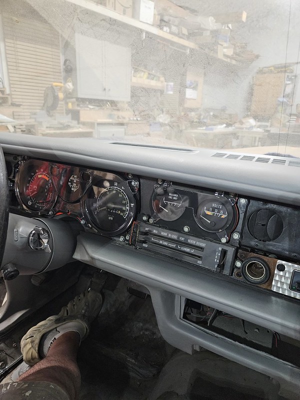

20240930_164730 by Kerry Grubb, on Flickr20240930_164743 by Kerry Grubb, on Flickr
Got a little shop time yesterday afternoon. Got the cluster installed, new speedo cable hooked up. I need to put the battery on the charger for a bit then will fire this beast up again checking to see what is and what is not working in the dash. If all is good then I can move on to something else. I did find when I was testing the lights a couple of weeks ago that my turn signal switch is junk! Not sure how that happened as I would have thought I would have checked it when I restored the column. I bought a new switch and need to replace that next order of business. Perhaps this evening if I am in the right state of mind.

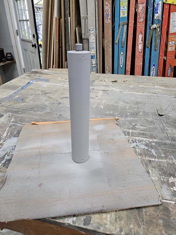

20240905_145620 by Kerry Grubb, on Flickr20240905_145944 by Kerry Grubb, on Flickr20240905_154028 by Kerry Grubb, on Flickr20240905_153604 by Kerry Grubb, on Flickr20240930_155657 by Kerry Grubb, on Flickr20240930_155539 by Kerry Grubb, on Flickr
This is the inflator bottle I decided to restore. After stripping off the cardboard I found the colour was actually a dark blue and not the lighter blue as it looked at the top. I only assume it has faded that much over the years. I had 3 'Pontiac' blues on the shelf and none of those matched. I did have a can of 'ford' blue that I got at TSC to match the colour of the motor mount and it was just about a perfect match to the original colour under the sleeve. I sanded down to bare, put a coat of high build primer, then a coat of glazing putty to fill any pits. Sand down again, a couple more coats of high build then the final colour coat of blue. Turned out pretty nice. I found a lable from The Parts Place. I replaced the cardboard sleeve with a piece of very heavy construction paper we use called 'Ram board'. HD has it for floor protection during construction. I wrapped it twice and glued it together then wrapped with shrink wrap as a clamp. I will finish it up later today hopefully.

20240909_134830 by Kerry Grubb, on Flickr20240930_171913 by Kerry Grubb, on Flickr20241001_120234 by 20241001_120300 by Kerry Grubb, on Flickrwww.flickr.com/photos/156399515@N07/]Kerry Grubb[/url], on Flickr20241001_120246 by Kerry Grubb, on Flickr
« Reply #627 on: October 01, 2024, 10:09:18 AM »
Not perfect, but came out good enough to throw into the trunk :-D

Great work Kerry! Do you have to send those bottles out to be hydrotested or is this now just a show piece?
« Reply #632 on: October 02, 2024, 07:18:03 AM »
Simply a show piece.
Yes, I looked everywhere and the label I got from the Parts Place was as close to the original as I could find. Obviously the one I had was in deplorable condition and it was not original to the car. The new replacement label was close but as another 10th pointed out the numbers are off slightly. I figured since it was a replacement bottle that I could get by with something a bit different. The tire sizes on the label are correct though. If I had one original to the car and it was even marginal at best I would def. keep it as is original. Keep in mind though, this car was literally a basket case when I got it!
