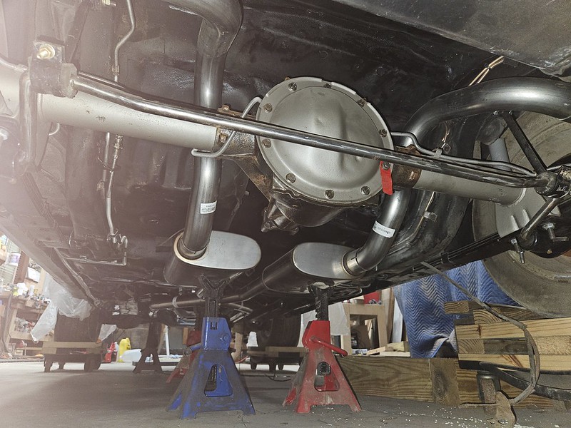

20240712_165916 by Kerry Grubb, on Flickr
20240713_164047 by Kerry Grubb, on Flickr
20240713_170216 by Kerry Grubb, on Flickr
Moving forward. Had to take parts outside to wash the years of shop dirt off! Got the inners installed, pass side fender loosely installed. Will hit the dr. side today.

Nice progress, Kerry.  Are you going to weld any sections of the exhaust?  I bought extra clamps but I'm going to weld some of the sections when I get to that point.
« Reply #540 on: July 14, 2024, 01:26:48 PM »
Kerry, nice looking exhaust with smooth bends. You might not care but it has to give you a HP boost over the catalytic equipped system with smaller pipes the car came with. I imagine it will sound a lot better too.

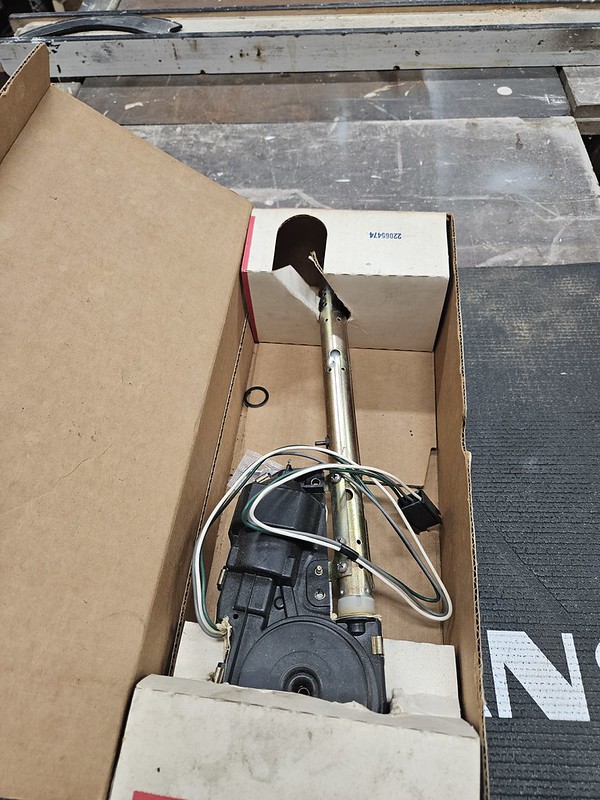

I did a favor for a buddy of mine a few years ago and he sent me this NOS antennae. Its just about too nice to use, but I have exhausted my search for a replacement that will look the same so I suppose I will get it bolted in place.
« Reply #544 on: July 22, 2024, 05:00:17 PM »
Dang, that NOS antenna is awesome!

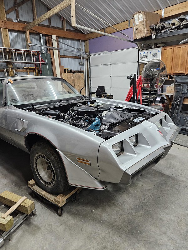

20240723_103514 by Kerry Grubb, on Flickr
20240723_102912 by Kerry Grubb, on Flickr
Set the hood in place today to check the alignment of the fenders. All looked really good. I just needed to move the front edge near the bumper in just a bit. I have 2 hoods to choose from in my shop. I was looking for awhile for a good one to use but gave up after not being able to find something decent. I really dont want to buy a repro as I have heard good and bad and dont want to end up with a bad one. I have decided to use the black hood. They both need about the same amount of work and I have been wanting to keep the TATA hood for wall art. It is not original to the car or I probably would use it. The black one came with the car when I got it. One of the original pieces that was missing.

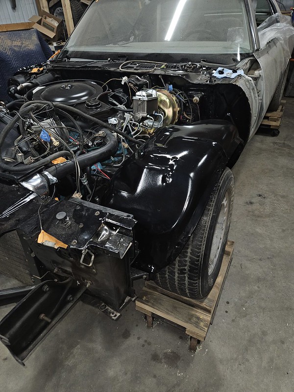

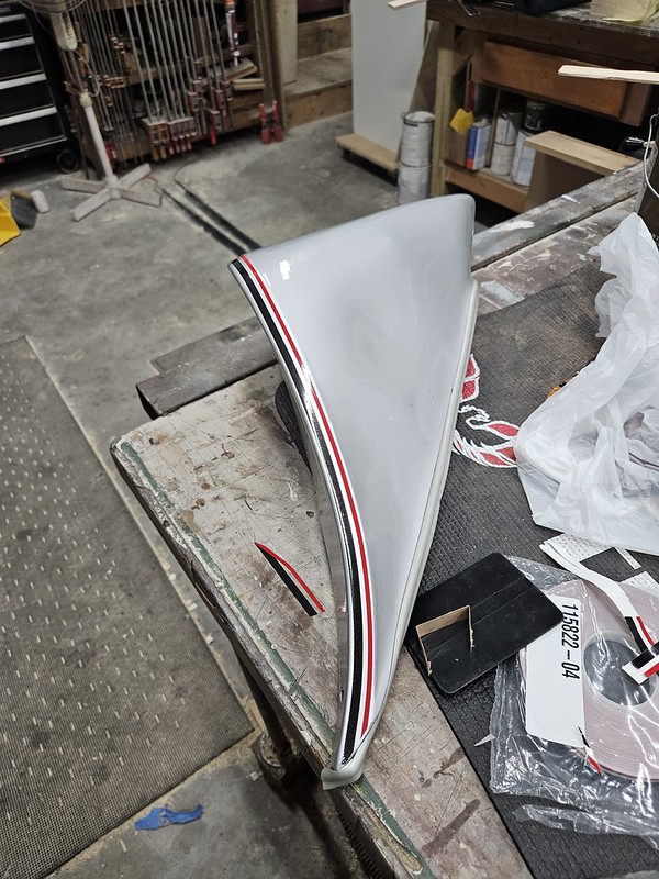

20240726_113213 by Kerry Grubb, on Flickr
Heres the backside of my nose piece. Not sure if I posted it before (years ago)when I restored it. Everything was new and refurbished. I forget now but I counted the pieces and it was in the hundreds!

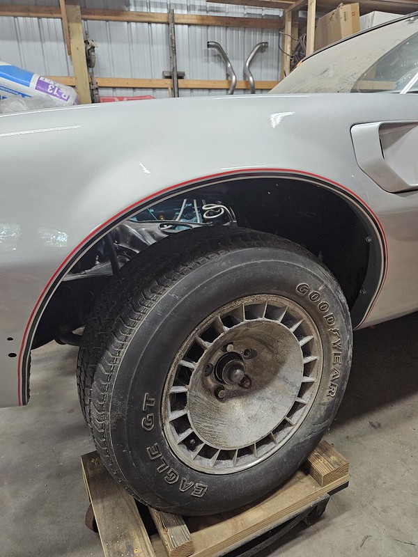

20240728_132728 by Kerry Grubb, on Flickr
I realized that I put the stripes on the front flares wrong so here they are done correctly. I forgot that they went across the front of the car as well. I will do the centre section once its installed.20240728_144221 by Kerry Grubb, on Flickr20240728_144318 by Kerry Grubb, on Flickr20240728_144210 by Kerry Grubb, on Flickr
Nose is bolted back into place for the first time in many years. I was surprised at how well everything lined up. The pic's show it right after I installed and all of the bolts were still loose. Its a bit tighter now with the bolts all socked down.
