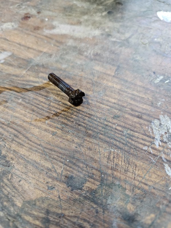

Got a few hours in the shop yesterday, hope to get a couple more today. I think all of the vacuum stuff is done. I have a couple of loose ends but the routing is all figured out at this point, which to me was the biggest hurdle. My builder put a single port to hook up the br. booster. Ames had a carb vac tree but its not correct. I got it and had to rig it up. It looks fine but not 100% correct. I found the right one and hopefully it will be here towards the end of the week. I looked everywhere but could not seem to find the right vac switches. Ended up finding some stuff from Franks. I got the power steering hoses hooked up -again got stuff from ames and its not right! They have been my go to forever but Im starting to see a theme here :sad: At this point just about everything is ready for a start. Just a couple of minor bits to take care of first. Enclosed is a few pics of some of the ports I got and cleaned up. Once everything is together as best as I can I will post an overall shot of the motor.
20231127_100543 by Kerry Grubb, on Flickr20231127_100935 by Kerry Grubb, on Flickr
Switch for the air cleaner. Not repro'd. Had to find used. Still looking for the clip that holds it in place.
20240122_135221 by Kerry Grubb, on Flickr20240122_150227 by Kerry Grubb, on Flickr
20240122_140348 by Kerry Grubb, on Flickr
Throttle kick down, cleaned up a bit and reinstalled.20240216_145951 by Kerry Grubb, on Flickr
20240217_125102 by Kerry Grubb, on Flickr
20240217_125706 by Kerry Grubb, on Flickr
3 port switch (broke) that was on my motor, the one I found from Franks then cleaned up. This mounts in the head at the pass side. Differs between auto trans and manual. I had one for auto, Go figure.
20240202_110502 by Kerry Grubb, on Flickr
20240202_110506 by Kerry Grubb, on Flickr
20240202_133639 by Kerry Grubb, on Flickr
20240202_134334 by Kerry Grubb, on Flickr
Gas pedal cleaned and painted. I took the metal trim off and polished it, cleaned the rubber pad between each rib with a nail to get all of the grime out. I did this awhile ago when I was waiting for parts. I find taking care of little things like this (minnie restoration) keeps the momentum going and helps mentally knowing that at least something is getting finished.
