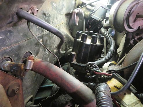

So with electricals on the list of "things to do", and the wiring I'm not too motivated to tackle..."yet", I'm looking into the ignition system, and decided to try and fit an old point dist. into the block, to see how much clearance I'll have against the firewall. And here is one shot, for your viewing pleasure.
Plenty of room, at least in its vicinity. Above it is kinda tight, but will still work. So many will say "why not an HEI?" I know most will have one, but I particularly don't like them. For many reasons, but one is their size. In this tight chassis, the more room the better. And it's not that I favor a point system, (but used them successfully for years), with an MSD box, you remove the points, and install their set-up. I like the idea of multi firing, and know it's been used favorably for decades. The unfortunate problem now-a-days, is their cost. They offer an MSD box, "with" a (a$$hole woke won't let me say the opposite of "advance") box which will set you back $700!!!!! :shock: Not for me. even W/O the "delay" box, they're still $500. Long story short, I purchased a brand new "BlocK" distributor system, which includes a dist. with a small black cap, rotor, module, external coil, and wires for way less than $300. Should be here tomorrow. hoping to find a used MSD at the swap meet, (or Ebay) for a better price. As far as a "delay" for ign. under boost conditions, looking for advice with that. Any takers?

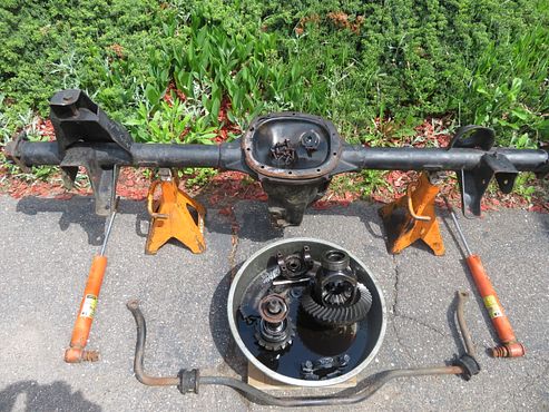

Testing only. Photobucket has a new format, and I've had problems (again) working thru them. The photo below is of the posi diff that'll replace the "gov-bomb" that is OEM installed, and said to not be too reliable. Hoping that the sensor ring won't be a problem seeing I won't be utilizing it.

What ratio is that? Just curious as now powered by a 301 manual.
Re: 84 301T
« Reply #414 on: August 31, 2026, 04:16:06 PM »
It's been a few months since I've been out there Luke, but I'm pretty sure it's a 3.23. I'll have-ta remember where I left off. (there's 2 3rd gen rears I just picked up). I'll have-ta look above to see. Yeah, that's what it is. If you'll remember my 84 T/A has a 3.23 gov. bomb posi, that I've heard are about as reliable as...well, I'm not gunna say right now. But when all is said and done, I want this car to be a 3.73 4 wheel disc car. Just to say it is. With the T-5 O/D, I'm sure the car will be OK at hi-way speeds. My 93 6.2 diesel stakebed 2500 has a 3.73 gear, and a 4L80 E tranny and runs good on the hi-way. Why do you ask? Do you need any 3rd gen parts?

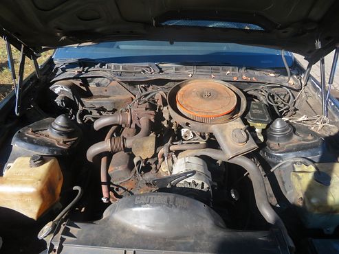

The eng. shot above is nothing new, and yes, is still filthy.  Me and the wife are looking for a replacement driver, (for her) Her Sonata is getting problematic, and we're looking at a low mileage 2010 Buick regal, (60K) from a friend. We'll se how it looks tomorrow.
