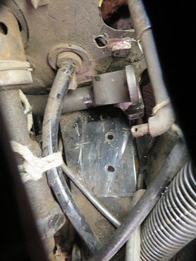

Here we go, men. Got the heat on in the garage. This is my focus. The linkage bracket on the frame is just a home-mader, and doesn't appear it'll work too well. The original bracket, (assy) from the factory 82 car, is a 2 piece afair, and I hear lots of negative about this set-up. I think I'm gunna remove mine, and remake it to use the holes that appear on the frame. (I marked them in yellow.)

So I finagled it for a bit, and went thru my scrounge steel, and angle iron, and can't find one single scrap piece of 3/16ths angle that I need. Maybe I can find something in work tomorrow. I think I could add onto my existing bracket. Will need-ta weld it together. I tried finding an original one (14078558) but I might as well been looking for the "Heart of the Sea" diamond.

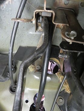

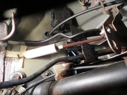

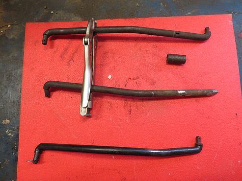

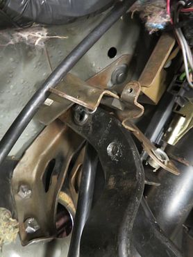

OK men, here we go. Made some progress tonite. I wish I could say the mech. clutch linkage is "done", but nothing in my garage is ever that easy. Got the bracket in place "temporarily", to give the system a test. If you've ever done any drag racing, and pushed on the pedal of a 3200 lb Borg and Beck pressure plate, you know how tough they are. Well, this system is tighter. (My pressure plate is a wimpy diaphragm.)  I got it to work, and it hasn't broken "yet", but until the binding is located, I probably won't be pushing it too much, cause something is out of whack. No way the 82 cars had this problem. One thing I don't and never had liked, was the Z bar upper pedal lever, is only a couple inches long. Not much leverage there. Then the pedal pushrod goes down on an angle from the pedal, and bends up going thru the firewall, out to the Z-bar lever. So you have this "bent" rod connecting them. And there's not much that can be done because the brake master cylinder is in the way. But once again, the factory must've made it work in 82, even tho I've never driven one. So here's some pics, as promised.

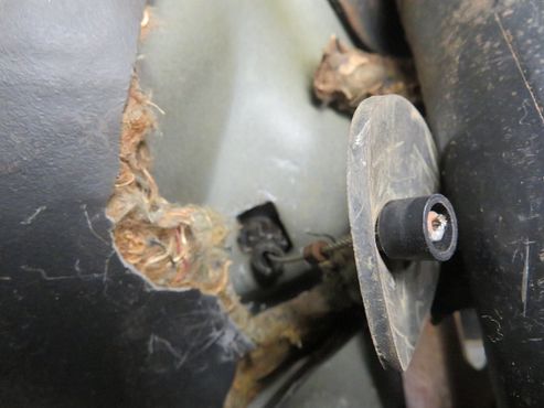

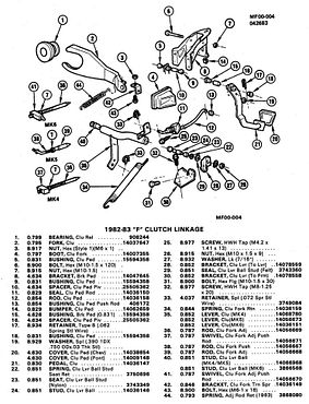

Below is the pedal pushrod situation. The lower one in the pic is the factory one, and for some reason is too long. (By a couple inches). Why? The ball location on the Pontiac block, is the same as the Chevy, so I don't understand why that is. Maybe because the clutch fork is different? Don't know, but we'll all find out, in time.
I was fortunate enuff to have some scrounge rods in my stash, and they were to become one. The middle one has the end gone, and the top one had a good end, so I cut the 2 of them to length, and joined them with a steel sleeve I had that was a perfect line to line fit. I haven't tacked them together yet, in case some alterations are needed.

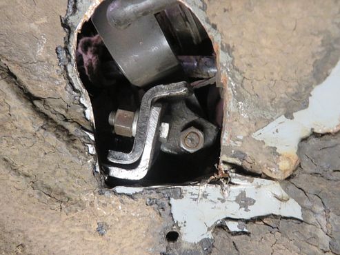

Once the rod was in place, because I found I had the small square factory frame bracket, (to the Z-bar end) I decided to try and fabricate the sister bracket that it bolts to. So just by going by pictures, this cabobulation below is what I came up with from scrap iron. Had a piece of 4" square tubing, 1/4" wall thichness, the same as the other bracket.  It ain't pretty yet but hopefully will serve its purpose. The other factory one is to the right.
So I drilled a hole to mate the 2 brackets, and lowered it onto the frame, just to get an idea. You can also see the sleeved pedal push rod.

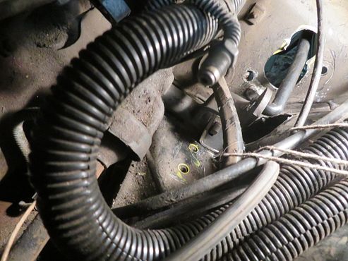

Next comes trying to accurately locate the position of the bracket, to the frame. But before I could do that, I had to tap out the existing mount holes for the bracket. GM made them M8-1.25-20 thread, but I decided to cut them for some hardened aviation 12 point wired head bolts that I had, that were 5/16x20. Most of you know how to tap, so I didn't take any photos of that.
What I have below is "my" method of finding holes. Because me and trig didn't get along, I made a clear plastic template, after marking out the perimeter of the bracket, nestled in its correct location. If you look close enuff, you can see the silver pencil outline of the bracket, the black hole dots, and the clear plastic on top. Then I drilled the holes.
So here it is, all bolted up. Not very exciting, but hoping to get it debugged shortly. Now I need-ta clean my garage that looks like a bomb went off.

Excellent question. Was curious about that, or how much disengagement it had. Long to explain, but I'm sure you'll understand.

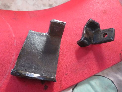

Before I made this "OEM" copied bracket, (dual bracket from the factory), I had made my own hodge podge one, just to see what I could conjure up. It's shown somewhere above, but I'll try and drop it down here. Anyway, when I had it hooked up, I "barely" had enuff pedal/fork travel, to make the clutch disc slip. I could barely slide in a .010 feeler gauge. The clutch fork was just touching the floor pan tunnel. (Before I hacked a hole in it for clearance.) That's about where I had left off with this project, quite some time ago. And I've "totally" forgotten how much tension was on the pedal when pushing it to the floor.
Now, with this new set-up, I was alone in the garage, trying to watch and see the linkage in operation. I finally recruited my daughter, (whose boyfriend assisted) in helping with this. Turns out, when the pedal is on the floor, it looked like the disc had a quarter inch clearance!!! :shock:Which is a good thing. Now I don't need the travel to disengage. At that time, it was late, and the force required to shove that pedal down was so  stiff, I'm afraid something is gunna give. So next, I'll try greasing the Z-bar/clutch balls, and other pivot points, and loosening the TOB pushrod a bit. Then stick on the brake booster temporarily, to see if I can extend the top lever. More pix to come.

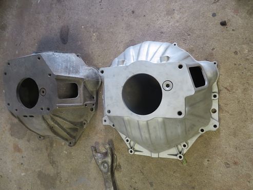

Oh yeah, I said I'ld show a photo of my preliminary attempt at fabricating a bell crank bracket, on the frame. Sort-ta the way most other Z bar mounts were attached. I did drill and tap it before using. The upper photo shows how close the fork arm is to the floor pan. I believe in that picture the clutch pedal is under pressure. (Maybe?) The entire reason the stick shift bellhousing on the 3rd gens, had the fork arm sticking out lower. I think I have a picture of that too. Here it is. Remember this dilemma? (Already posted pages B4)
Notice the fork arm hole locations? I paid $100 for this bell, thinkin it would make life easier. It also incorporates the BOP bolt pattern.
Did it work-out? Course not. Why? Because the chebby flywheel is a smaller diameter compared to the 166 tooth Poncho. The unibell  is smaller, so the Pontiac ring gear hits the 6 o'clock position of the smaller uni- bell housing. Won't go on.  :-x But we already went thru this. So anyway, after I put my mess away this weekend, I'll be raising the pedal pushrod up, temporarily mounting the brake booster, looking at clearances, and seeing if there's still enuff linkage travel to disengage the clutch disc. OFN.

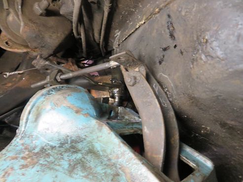

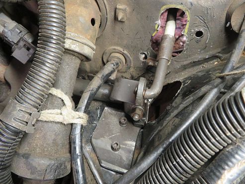

Well people, a major milestone has just occurred, (at least for me) regarding this project. And the difference happened in literally a few minutes. But before that, after work yesterday, beginning my weekend "home" and not at work, with me planning my garage time, the Mrs. tells me, "my car is broken". My reaction (?)... :evil: 2013 Sonata 302 code, misfire. Not to bore you, but fortunately it was an easy fix, (this Valentines day) with a coil replacement, that is easier than an oil change. Had to replace one last year, that also crapped out. She tells me she had a garage talk her into replacing them all (4 sillywinder). just a couple yrs before that. Chinese junk. 2 are still left in there, and am waiting for their demise. So much for that distraction.
And on to 84 T/A time. Left off with home-made clutch bracketry, lots of clutch travel, but also tons of pedal pressure. I mentioned a buddy telling me about moving the pedal push rod to an upper hole on the pedal shaft, and VOILAH!!, pedal pressure back to normal. And with clearance in the floor pan, it "appears" to have enuff travel to disengage the clutch. Is it enuff travel? I can wiggle the outer rim of the clutch disc with a screwdriver, and get a .015 feeler stock in there. That's with the pedal on the floor. I'm hoping in the future there will be enuff adjustments to ensure it'll work, "in the field". Time will tell. And here's some final pics of the entire mechanical system, in operational form.

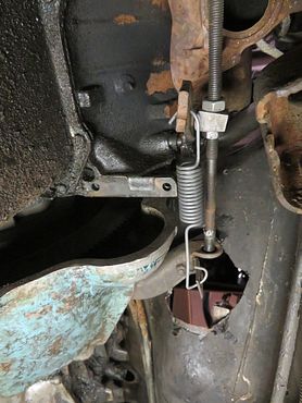

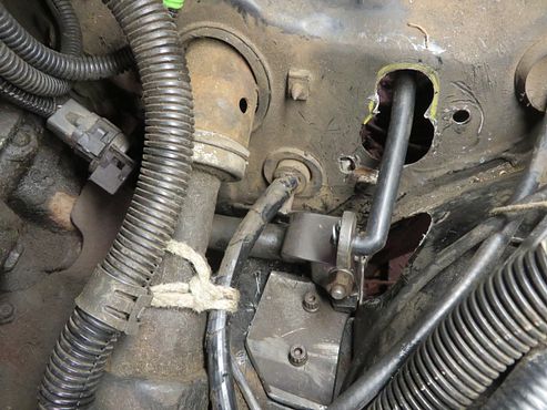

 Below is a view of the pushrod attachment points. You can see the lower hole now empty, and the rod in the top hole. And it's the factory rod, not my shortened custom one, for the lower hole.
 And the lower lever linkage to the clutch fork. Will be cleaning all that "experimental" lever and rod parts up, during the O/H.

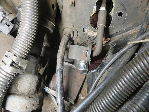

And finally the same 2 piece bracket, with the "correct" pushrod coming thru the firewall, and the clearance. I notice some minor deflection on that 2 piece bracket, where they are bolted together, under a load. Not a lot, but with 2 pieces of 1/4" steel bolted together, you'ld think it wouldn't do that. Goes to show how much force is applied to those parts
So, with all the above clutch components functioning properly, the eng. fitted to the mounts, the T5 mounted with its modified tilted tailhousing mount, the torque bar bracket fitted to the tranny,  and the functioning cold air cowl inducted hood system fitted, I think I'm at the point of taking it all apart, and start the rebuild. Which will entail a final pressure wash of under the hood once the eng. is removed.  Then I think I'll focus on rebuilding the 301T, which will include the turbo too. How many modifications will I apply? I've had some ideas, but haven't decided what path to take...yet. I'm sure I'll be recruiting some parts, assistance, and advice from Joe at TTA. (And that's all I'm gunna say about that.) :)
« Last Edit: February 17, 2026, 05:22:12 PM by tajoe »

I believe there is clearance SB. The pushrod in the photo can be cut way down. I'm using it right now cause it's the one that was on it. That, and the lever hanging down need to be tailored and cleaned up. The lever is pretty raggedy.
 I made comments above about rippin everything apart, and start to rebuild the 301, but I think I'll play with the existing exhaust pipes, and revisit those areas, like I did a few pages back. Also the wiring, the throttle cable, and the accessory mounting, (like the alternator, and P/S pump) will need adapting. I'm sure those will take some time and finessing to make work. I'll need-ta see how much of those items from the past, are still in my collection.

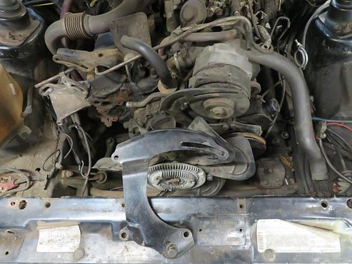

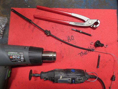

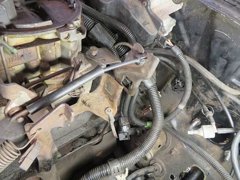

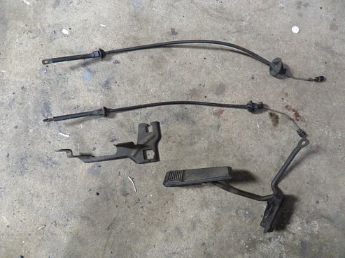

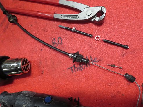

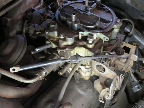

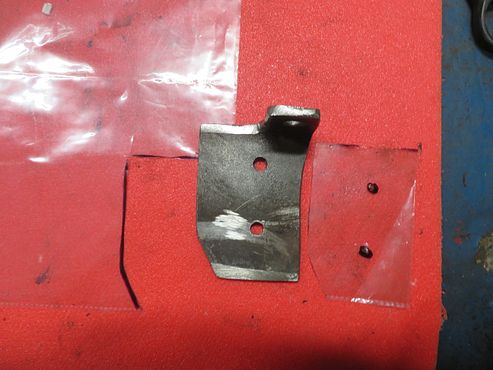

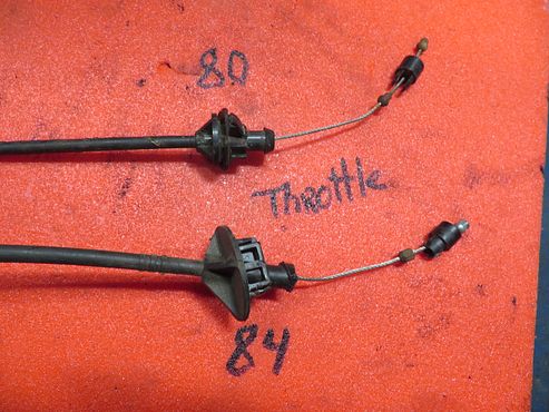

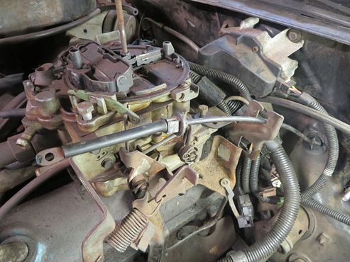

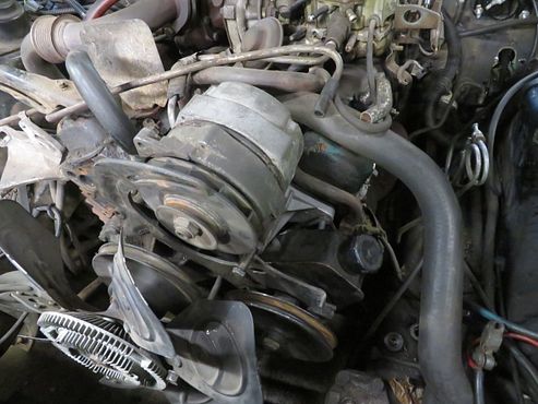

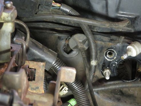

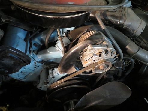

And speaking of rummaging thru parts, the brackets mounting the accessories have been in my stash for literally 3 decades, (since I remember seeing them). And I'm sure, (at least for the original alternator) that I scabbed it for another job, and probably removed the 301T brackets, and "set them aside"...30 something yrs ago.  :-?  I've spent a few hrs over the last couple days "searching", but to no avail. I'm sure they're here...somewhere...but I found a set-up for my P/S pump on Ebay, reasonable. So they should be arriving by the weekend. Same problem with the alt brackets, but I'm not buying them yet, because I'm hoping to be able to mount it on the passenger side, rather than on top of the P/S pump, like the factory did, due to the AC compressor and smoke grinder, (which I've removed both) .
However, in my search, I "did" find the 301T 80 T/A throttle cable, and bracketry, which is a relief for me. I'm in the middle of mocking it up, and will post more pics when the P/S pump brackets arrive. OFN..again.

And the "beat goes on". Quite a few hrs invested, with some fwd progress. Satisfyingly is the mounting of the P/S pump. The brackets purchased worked perfectly, so I can cross that off the list.
Next concern is the alt. mounting. As I previously mentioned, I refrained from buying the factory alt. bracket/s because I was considering a RHS mount, "but" as I got the P/S pump mounted, I see that all I need to mount the alt. in it's original location, is the large frt bracket. And I did have one in my stash, but I wasn't able to make it work before. Maybe if I reinvestigated, I could. After trying this weekend, it's a given The bracket won't cut it. After researching on line, I see that RHS mounting isn't as common as I was hoping, so for $20 and shipping I purchased the factory correct plate, (for now) and am waiting for it to arrive...in a week. It amazes me how many of this style mounting plate is available. Unfortunately there are so many different ones, not one size fits all. :(
Below is what I started out with. You can see the frt bracket won't wrap around or clear the alt. fins. Its shape is wrong. It does bolt everywhere else tho.
And once again, I started hunting for the right one, and low and behold, what did I see? On the frt of my 73 T/A, I see where I must have put it.  :shock:
OMG! Is that where it's been all this time? So I ripped it off, and tried it on the 301, and.....No...It wasn't it. The shape looked better than the one I had, but not exactly from photos I've seen. So now I wait for the mail order one to arrive. Now I will post this, and my next one will be of the throttle cable modification.
« Last Edit: February 22, 2026, 04:49:49 PM by tajoe »

To start off with, the carb mounting on the 301T motor, is closer to the drivers side than the centrally mounted QJ on the 305. The original cable was still attached to the firewall, and below you can see how long it is.
So what are my options? Are there different length cables available thru the aftermarket? Is there a factory one that'll fit? (I doubt it). So I knew the original wasn't gunna work, so I removed it, to examine it. And it wasn't an easy task, workin under the dash, peelin back the floor insulation, ect. All that was needed was to compress the ears on the plastic firewall "clip" (?). Don't even know the proper terminology. All I know is, under the dash in these 3rd gens aren't for the faint of heart. (No room to work). This is what the plastic clip looks like from underneath. At this point, I had cleared the insulation to access it, and finally got it unclipped and pushed thru the firewall. In the foreground is the rubber washer that seals it, (that's slid down to the end), and the swedged end for the pedal. The pic below it, is of the cable unclamped from under the hood.
And below is a comparison of the original, to another one I found in my stash. In the past, as I disassembled a few firebirds, I wasn't too dedicated to labeling everything, cause I hadn't planned on reusing this stuff. Now...I wish I did a better job. Some stuff I did, but obviously, not enuff. On the replacement one, I did have a bracket to mount a cable to the back bolts of the QJ.
Now a plan is needed to shorten the 2nd one. How do you do that? Because this one is an extra, and I didn't wanna cut the original, i started hacking away at the extra one.
Step 1, was to see if I could remove the black plastic clip for the firewall, W/O destrorying it. It was needed to mount the cable but needs to be slid up to be shorter, and I figured it was molded to the cable housing. And it was "tight". Long story short, by using a cutoff wheel on a Dremmel, I sliced it lengthwise, pried it apart, then heated it with a heat gun to soften the plastic, and twisted it loose...finally. I'm not gunna show you how ugly the cut was, so you'll have-ta use your imagination. :lol: But I was able to remove it, and think it'll be reusable. In the upper photo you can see the clip differences. Below is the cable in pieces, and cut. Unfortunately I didn't remove enuff, and had to cut the outter cable housing twice. You can see the carb picture showin how much i missed by.
The method I used to shorten the cable housing, was to take the cutoff wheel, and "GENTLY" slice into it a little at a time. Till it reached a red insulating tube for the inner cable. And as much as I hated to, I  committed myself to cutting off the swedged end off, to remove the cut up cable housing pieces, and slide them off. I then mounted the removed pieces to check the length. As I said, above, I had-ta cut the housing twice B4 I honed into the right length. Below is the "temporarily" assembled cable, with a pic of the Keystone clamping tool I'll use to clamp the clip on. And the final length I'm hoping will work.
And because the clip on the cable for the firewall isn't a perfect fit, I'll need-ta improvise something to attach it more securely. I'm pretty optimistic it'll work. So that's it for now folks. hoping no-one has posted whilst I've been working this post. It's taken a while. I'll answer if needed.
