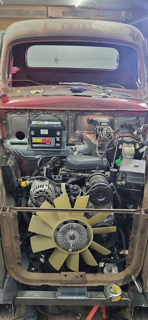

« Reply #214 on: April 11, 2026, 03:16:37 PM »
Trying to route wiring to see where items like the ECU, ABS pump, battery and fuse box need to go.
These have to go in roughly these locations unless I want to rewire things, which I don't. I got them all mounted by making custom brackets. The stock S10 intake system will not work as it is setup to face the drivers side and there is no easy way to flip it with what I have. I did find that 4.3 silverado's use a pasanger side air intake, so I'm searching for a reasonable priced hat from one of those.

« Reply #215 on: April 11, 2026, 03:41:37 PM »
Luke, nice job with the engine compartment layout. All those extras that didn’t exist back in the day.
Re: F1 Project
« Reply #216 on: April 11, 2026, 06:04:55 PM »
Thanks! It will all have to come apart now for paint.
Re: F1 Project
« Reply #217 on: April 13, 2026, 08:03:46 AM »
Looks like a solid mock up to me. Looks like plenty of space to service items in the future.
