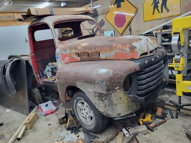

Here is how it sits today. Still on the junk test frame. I cleaned out all the pictures from my phone because I ran out of storage so this is all I have. I did have some pretty intricate panels that I made using the English wheel, bead roller, brake and other hand tools. But unfortunately those got move to a thumb drive somewhere.

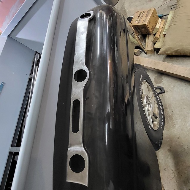

So, since this is not an original truck, just a collection of junk new and old I need to try and hide as much of the new as possible.  I have the 4x4 and airbag switches to hide. An original ashtray is kinda expensive and not really needed. I decided to make a panel that resembles the original but open. I will hide some of those weird modern S10 switches in here.
I think the door itself came out pretty good. The hinges are just roughed in for now. The geometry of hinges is crazy, I really don't understand them and how to get things to land where you want them. I don't have CAD or anything to compute what I need just 17 tries of cardboard and metal options until I got it close and functional.
I know it doesn't look like much, but this took many many hours.... sad...

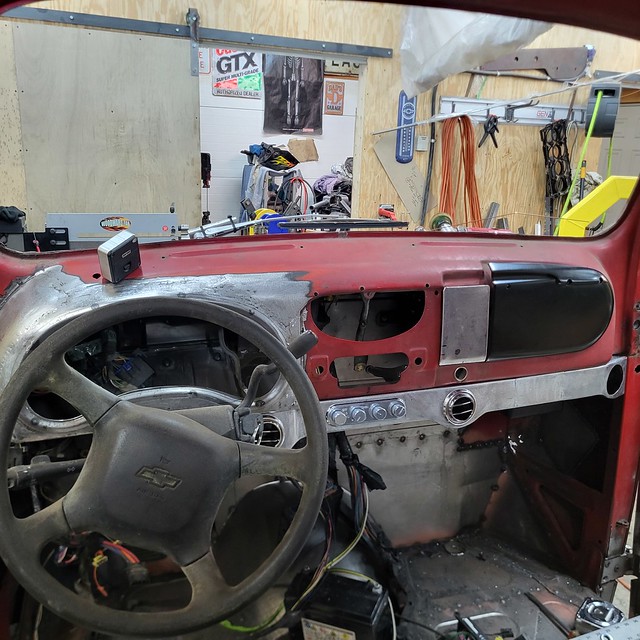

Started mocking up the AC unit. Decided I needed to make an under dash panel to house the controller and vents.  I will probably put the engine in place so I can figure out the abs pump placement as well as the battery tray and other under hood items.
Here under the dash on the bottom right you can just barely see the AC box
Here i cut the hole to run the AC and heater lines out.
You can see the panels I've been working on under the red dash. I've had to make this in several seconds.  I just need to make one more piece and then join them all and cut the holes for the vents and controls.

Kinda finished up the lower dash panel today. I'm not a great metal worker like those on YouTube shows but this came out pretty good i think. I TIG welded each little section together and was able to blend it all together pretty seamlessly. I didn't want to build a completely custom dash so this lower section bolts on and is easily removable so other under dash items can come out.
I still need to make the drivers side vent pod thats left of the steering wheel and order 2 more round vents.
Now that I'm almost done with the dash, I'm thinking it may have been easier to just go full custom...
