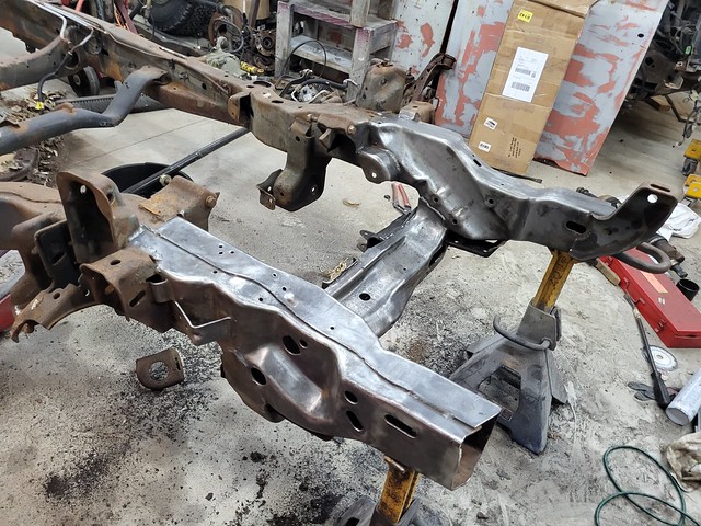

Got the front differential out and the rest of the steering components. I had a little time left to start cleaning the frame. It is really cleaning up nice. I also started removing the body mounts and any other items welded to the frame that I won't use.
« Last Edit: December 01, 2022, 07:17:34 PM by FormTA »

Luke, you sure are doin it right. And that is some kinda frame. Talk about your "Super Duty". When trucks were strong, and long B4 uni-body cheesed out our traveling machines. Great progress.
Re: F1 Project
« Reply #21 on: December 01, 2022, 07:42:26 PM »
That’s dirty hard work, sure looks good cleaned up. I am one of those people that love a clean frame and undercarriage! I agree with TAJoe, that’s a beefy looking frame, much stronger than what they dreamed of when your F1 was initially built.
Re: F1 Project
« Reply #22 on: December 01, 2022, 08:21:32 PM »
Ya, S10s were actually pretty well built trucks. The frames were boxed from the factory and the Zr2 used the full size rear axle.  I may have to remove a leaf and run the torsion bars a little loose to help with ride quality.  I don't know what the weight difference is between the f1 body and the S10 body. The Zr2 was an extended cab and I will have to shorten the frame about 12" or so, which won't help....

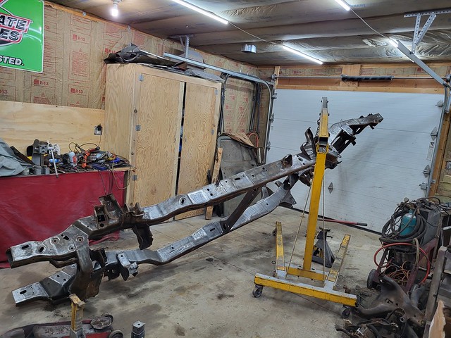

I finished wire wheeling the top side and pulled the rear-end.  I need to find a replacement rear axle as someone pulled the center section from this one. I have a lead on one close to me, if that falls through I'll order gears and a limited slip unit for this one and rebuild it.
I have run out of parts to remove from it.. .
I then flipped the frame over by myself and my cherry picker.
That was a little sketchy at times.
Just have to wire wheel the bottom now. I picked up 400lbs of blasting media so once I have the bottom clean of rust I will be blasting the whole thing and epoxy it.
Any suggestions on what, if anything to top coat the epoxy with? I want a satin look. I was thinking maybe rustoleum but that stuff never seems to set up hard enough. I may just put multiple coats of epoxy and call it a day.
Oh, I picked up and swept the shop. Can you tell?   :-x
« Last Edit: December 12, 2022, 07:44:01 PM by FormTA »

Oh and FWIW, what I did with the frame on my 68 was used a product from Rustoleum that is very similar to POR15 but is oil based. It makes sense to me that a paint to prevent rust would be oil based rather than water based like most. What I did was painted the whole frame, then topped it off with a satan black while it was still wet, and it came out just like a factory finish. It was super strong and durable the whole time I had the car. Only drawback is that it takes a long time for the paint to fully cure. I think it was about 3 days before it was fully dry.
