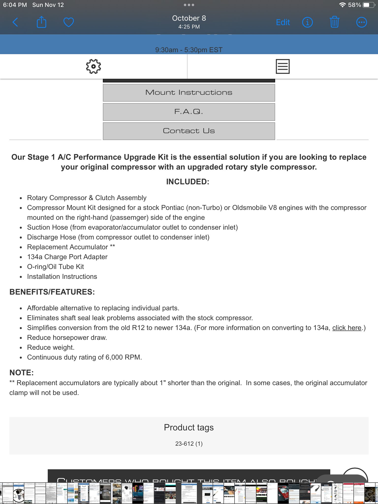

As I mentioned yesterday the upgrade kit arrived on 10/08 and was well packaged. I opened the kit and took inventory. These are the installation instructions I received.
img20231114_19042184 by Lawrence Alexander, on Flickr
On 10/09 I called Original Air and told them the installation instructions were not legible. They immediately sent me a .pdf with the instructions.
On 10/10 I started mocking up the pieces and realized the suction and discharge hoses they sent me were too small at the compressor end. I called Original Air and explained the hoses would not fit the compressor. I was told I had to submit a warrantee claim. I immediately filled out an online claim form with a picture showing the difference in hose size versus the compressor fittings. On 10/12 received an email saying they will get a new discharge hose sent out to me. Before I could reply back saying both hoses would not fit (1:15 latter) they sent another email. The second email reply " As we're looking into the issue it appears that what actually happened is we received an incorrect batch of compressors from our supplier". "They won't fit the mount or the discharge fitting". "We are looking to see if we have any of the compressors in-house right now". After receiving illegible installation instructions and the wrong compressor I am questioning the lack of attention when they packed my kit that took a month to assemble and ship. Nine days pass without any email or shipping notification of the correct compressor. I call back on 10/19 and ask what's going on. They say they want to me to send back my compressor and they will switch the plate at the rear of the compressor to one with the correct fitting size. My reply is this is unacceptable, I want the compressor factory sealed sent to me. They reply it will ship on 10/20. On 10/26 I call back asking for tracking information on the compressor. On 11/05 I finally receive what appears to be the correct compressor.

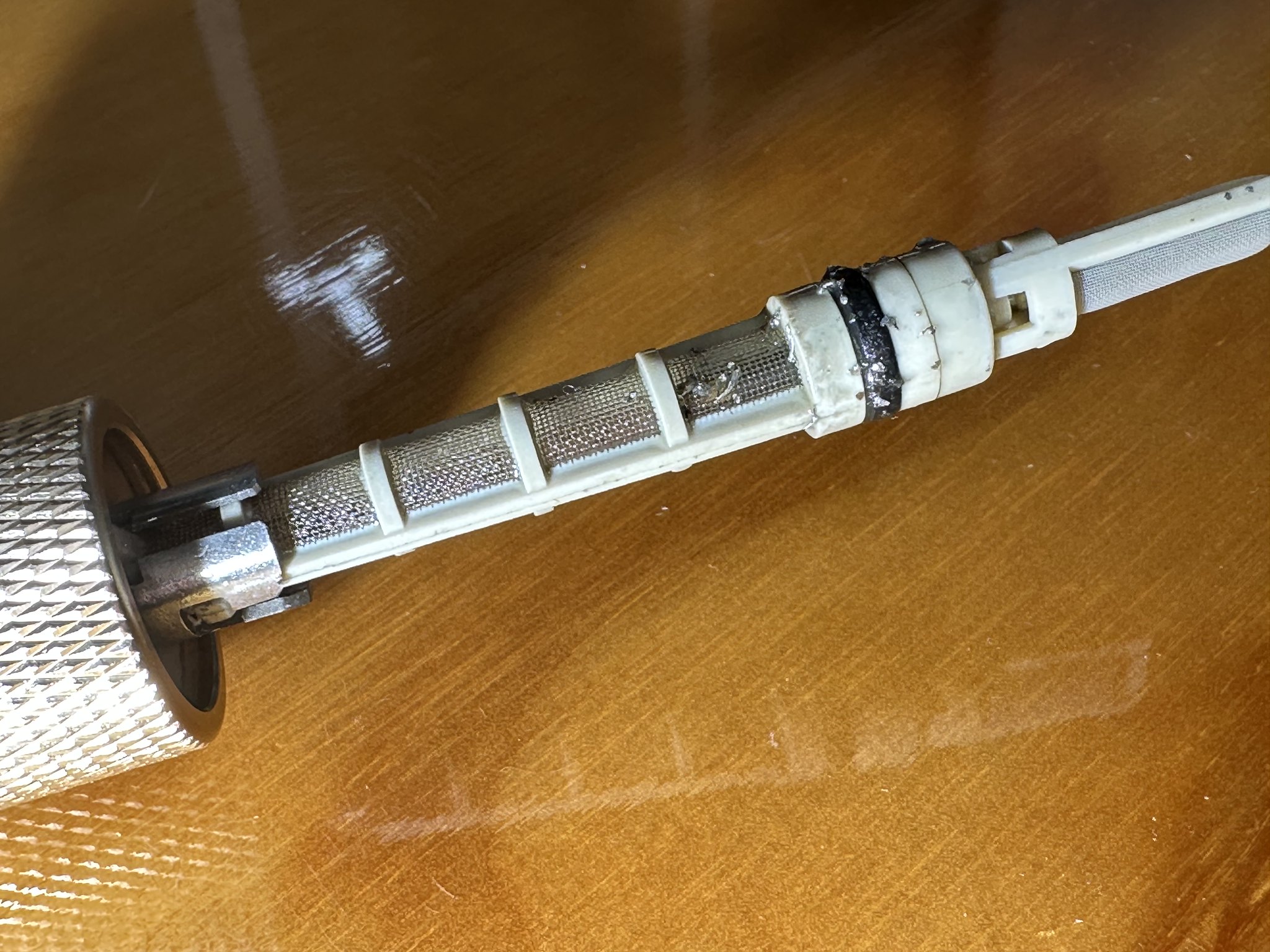

Before I could flush the evaporator I had to remove the orifice tube. I tried using a thin nose piler but was unsuccessful. I did some you tube research and found out that this can be a difficult task A special tool is often required and sometimes requires heat. In some cases the orifice tube can break, requiring replacement of the evaporator coil.
I found removal tool online, cost $12.00. the tool grips the orifice tube in four places. It took three tries before I was successful in removing it. I was getting a little nervous. What I found was a little alarming metal debris, non ferrous in the tube.
Original orifice tube installed in evaporator, somewhat damaged from my piler.
IMG_2604 by Lawrence Alexander, on Flickr
Original orifice tube removed.
IMG_2605 by Lawrence Alexander, on Flickr
New Orifice tube, attached to removal / installation tool.
IMG_2600 by Lawrence Alexander, on Flickr
More to come!

That orifice tube removal tool causes me problems.  It tends to slip off of those two little tabs at the end of the orifice tube housing.  Sometimes it also damages the tabs.  Because of this, I typically use a hemostat and clamp it to the end of the orifice tube housing.  That works all of the time.
I'll use the orifice tube tool to install the new part.
