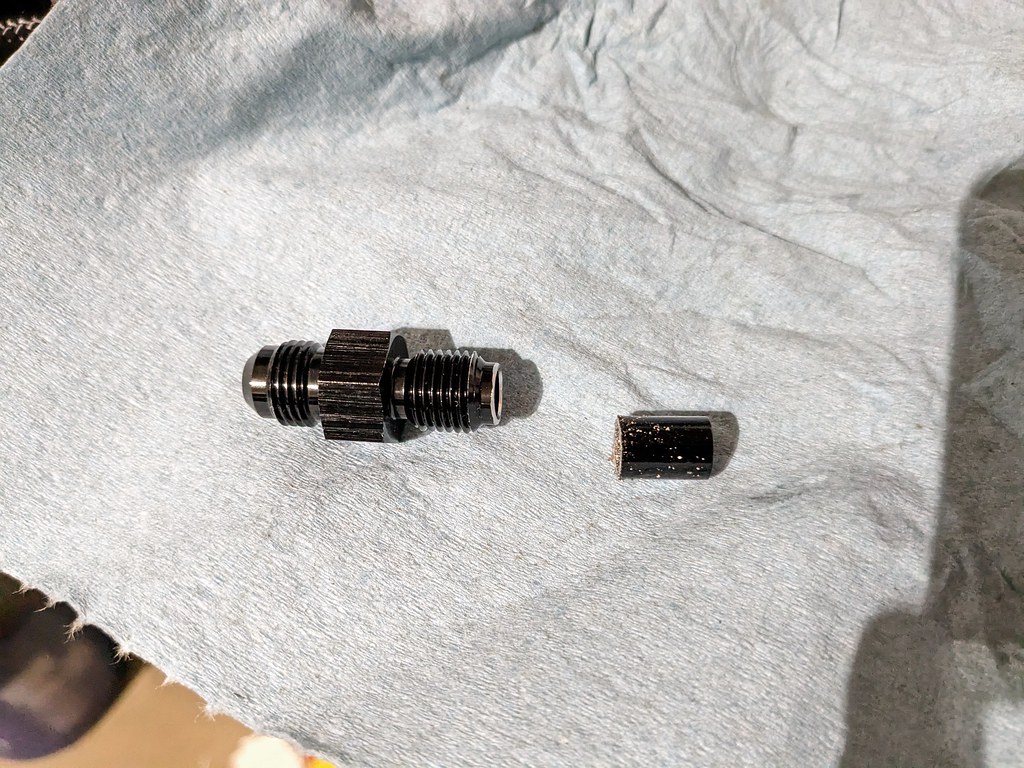

I bought a new union to replace the one that I bought a few weeks ago and while I was inspecting it, I noticed that there was a large burr inside. Just a reminder to always check your new parts.

I am still chasing a transmission leak and replaced the Jiffy-Tite fittings with -6 AN so I can also add a cooler. I ordered all but two fittings, and decided to just cut a short section off of the hose to make a by-pass to check for leaks. I had hoped that would fix the leak, but it don't believe it did. It didn't leak as much after I parked it, so it could have just been some residual fluid on top of something, but I don't think I'll get that lucky.
The install went pretty smoothly, but the Jeg's AN adapters for the 4L80e I ordered did need to be modified. The rear one fit perfectly, but the front one was too long. I had to cut off a section and taper some of the threads on the end for it to fully seat. But otherwise, it all seems to have sealed up without any issues.
