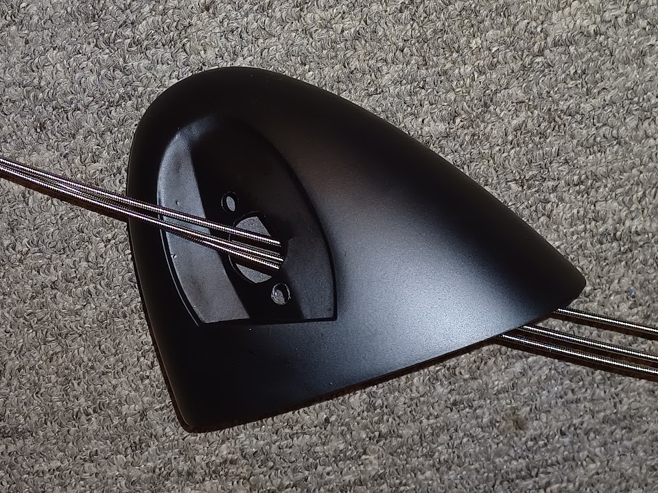

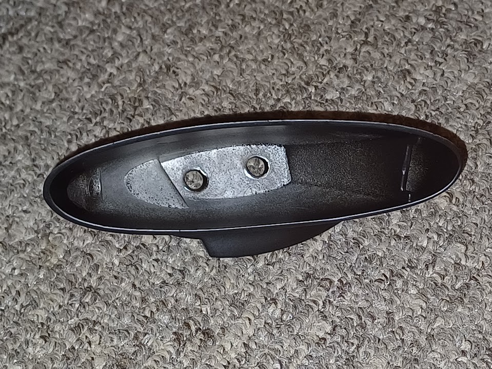

70-81 Firebird sports mirror mounting gaskets.
Original Firebird gaskets were #9832127. Camaro used #9832126.
They were tapered opposite to match the opposite curves these vehicles have at the door top. As well as this, there was an offset pin so the gasket only went one way on each door, always the right way up.
The reproduction guys decided they knew better, removed the locating pins, removed the taper and marketed one gasket for both. This also meant neither vehicle could have mirrors that mounted straight. The OER version still shows the GM number 9832126 and mods are visible. More recent runs have no part number as shown in photo below used gaskets.
Another company is listing their own "#9832127" gasket, but again, list it is for both cars, which is incorrect, regardless of which way it leans.

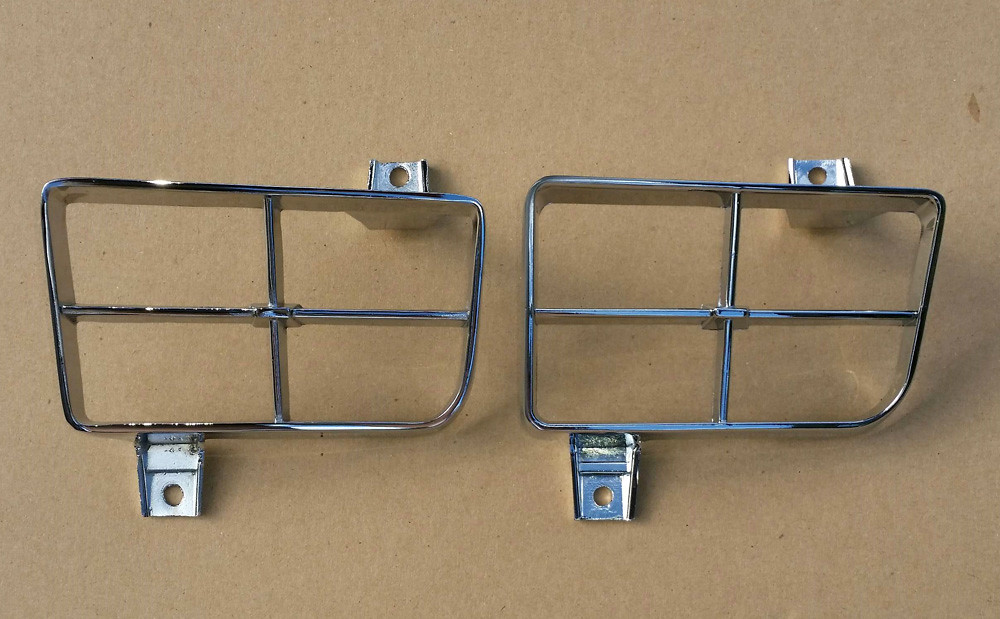

1977-78 chrome park lamp bezels. #499855 + #499856.
These are the GM-approved Australian reproductions from Pontiworld. Some US places also stocked them but don't identify. I believe there is now another supplier, unsure if same castings rebranded.
Reproduction bezels and lamps.
Park lights repro bezel and light 1 by Aus78Formula, on Flickr
These are my photos of an original GM set I had rechromed on the left, reproduction on the right. The rechroming alone was around 3x the purchase price of the reproduction bezels. Even after I spent a lot of time cleaning up the castings prior, the new bezels were still nicer and matched where needed. A very good reproduction piece at good price. A rare example where the reproduction is actually a better item than the original and NOS.
park light bezel rechromed original repro 1 499856 by Aus78Formula, on Flickr
park light bezel rechromed original repro 2 499856 by Aus78Formula, on Flickr
park light bezel rechromed original repro 3 499856 by Aus78Formula, on Flickr
park light bezel rechromed original repro 4 499856 by Aus78Formula, on Flickr
park light bezel repro 1 499856 by Aus78Formula, on Flickr

I wondered why I could not get the mirror base to line up all that good!

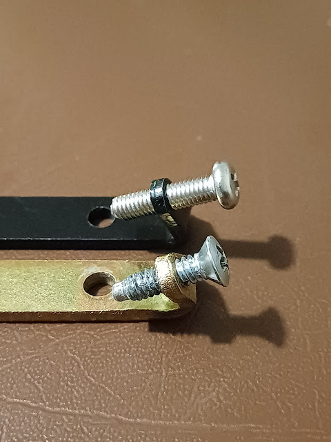

After many years I finally bought a set of sun visors for my 77 t/a.
I got the visors and the mounting/swivel bracket from Ames. The parts were excellent, the bracket has great chrome and is heavy duty. Compared to the original from my 79 it is what I would call a perfect part.
IF I have one complaint, right under the bracket number in the catalogue, is listed "mounting screws". So naturally I clicked on that 'part' as well. It was only a couple of dollars but when I got the parts in the mail the mounting screws come with the part. The additional screws were not needed.

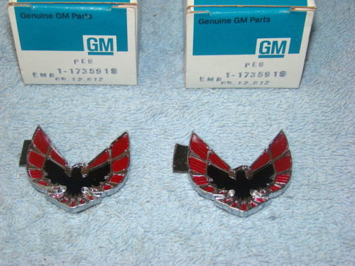

Door Panel Emblems
NOS on the left.......Repro on the right
Re: NOS vs Reproduction
« Reply #24 on: March 07, 2023, 03:55:21 PM »
« Reply #25 on: March 07, 2023, 03:57:54 PM »
On the outside sections of the wings.......count 5 down and you can see the difference in size of the last piece.  Also, the grain is less dense on the repro.
The tips of the wings on NOS are more defined than the repro.
NOS first pic
REPRO second pic
« Last Edit: March 07, 2023, 04:02:42 PM by wheels78ta »
« Reply #26 on: March 07, 2023, 03:59:44 PM »
GM part number on NOS.  Nothing on Repro
« Reply #27 on: March 07, 2023, 04:01:14 PM »
The three tabs on back of NOS are a little thicker and rounded on the ends compared to the repro.

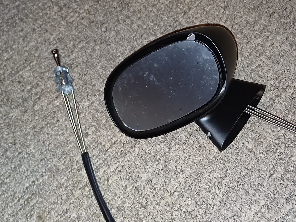

Anyone sick of door mirrors yet? I found something quite intriguing.
I’m curious at least lol

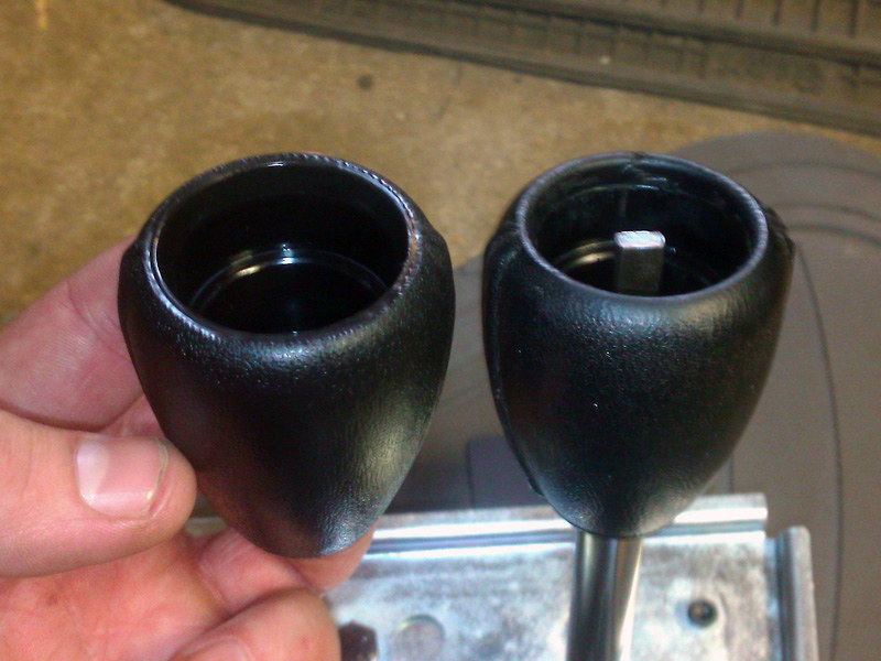

Auto shifter knob.
NOS GM installed vs Reproduction from Pontiworld. As perfect as they get to being identical in detail and quality.
Firebird Auto shift knobs repro vs GM 2 by Aus78Formula, on Flickr
Firebird Auto shift knobs repro vs GM 1 by Aus78Formula, on Flickr

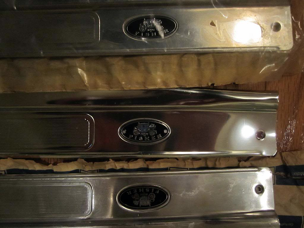

NOS GM #9819033/9819034 door opening scuff strips vs glossy reproduction strips.
Various brands, slight variations but mostly similar. Reproductions polished far more than original GM stainless, lighter gauge. The ends of the reproductions don't always curve over to match the side sill or plastic trim of kick panel/rear armrest. Luckily, easily rebent by hand to wrap over. The Fisher decal can differ. Early years were held on with 2 actual rivets, later stuck on. Reproductions can be stuck-on, possibly have rivets, or have imitation rivets like photo.
NOS door stainless strips vs repro shiny scuff plates by Aus78Formula, on Flickr

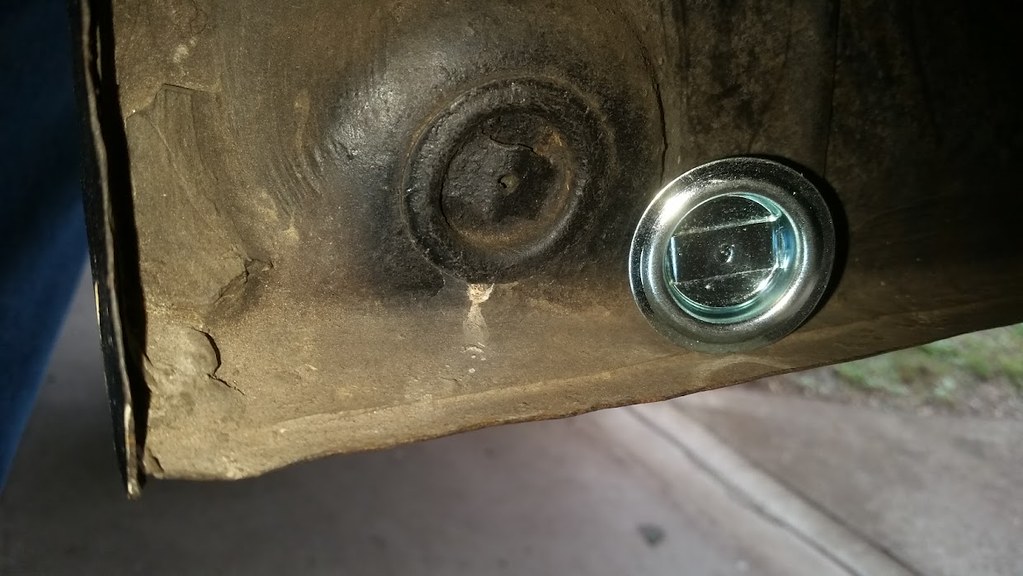

Rear rocker panel dust flap seal.
Original GM still installed.
Rocker dust flap seal by Aus78Formula, on Flickr

I left this one alone as I don't have the full information required. But the original production line 75-78 sail panel GM bird was the pointed wingtip type #1735919 and the later spare parts reproduction is the cartoonish version, which also seems to have been stocked by GM but supplied to them by another emblem maker for whatever reason. For the sake of comparing I've called the original type the GM type, and the later GM spare, the cartoon reproduction version.
A later reproduction that appears to have supplied the original style again seems to have followed in the original form and same moulds. These have two mounting pins cut off and double-sided tape, no GM or casting numbers. They had light blue tape to peel off from the side, the cartoon type had red that peels from the bottom. The originals have a flat cast back, the cartoon type has a border. I have not seen the rear of the cartoon type under the adhesive. I have also only seen them applied to 'restored' or tidied-up cars, never an original vehicle, so far. Even if they were original, they are terrible.
I have NOS versions in GM boxes and GM packets, also a few old stock emblems from early reproductions and they appear to be one and the same. The clear resin top could yellow with age. Don't be fooled by those trying to sell the rare 'Gold' and red versions, it was just badly yellowed over the chrome.
NOS GM original style emblems, box and packet
Firebird sail panel bird emblems 2 NOS 1735919 by Ben, on Flickr
GM NOS 75-78 sail bird emblem 1735919 (1) by Ben, on Flickr
GM NOS 75-78 sail bird emblem 1735919 (2) by Ben, on Flickr

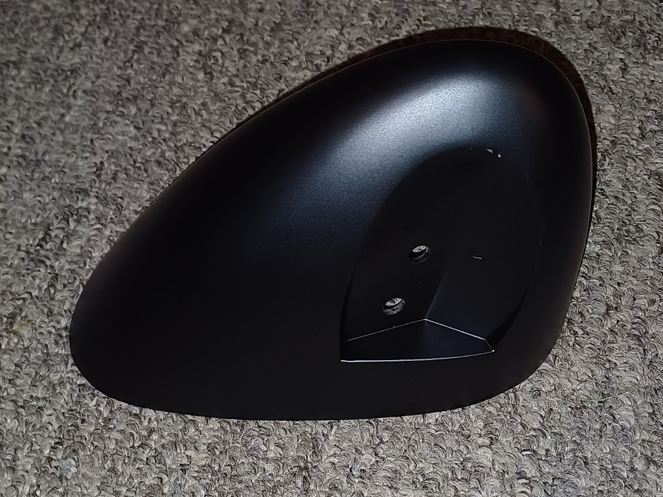

I picked up an assortment of parts, included were a set of the new The Parts Place reproduction bullet sports mirrors. These appear to be different from the OER version, at least in photos used by sellers.
This is the RH door mirror.
On close inspection they look the part and very clean unit, I even noticed a casting number inside of 52811 that was used in the mid-70's with the KBC cast units by GM. I was hoping they were a copy of the same casting, but they appear to be only based on it. The glass has a protective plastic on it.
TPP repro RH door mirror 52811 lightweight copy (1) by Ben, on Flickr

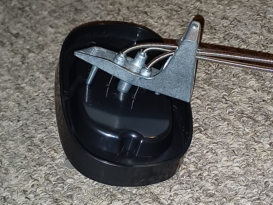

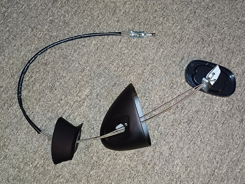

Naturally, I pulled it apart to inspect. And that's when you notice the first thing, just how light they are. I had to have a loser look as though for a moment they may have even been cast in plastic, such is the weight and amount the head flexes. They are only slightly thinner than original but a lot less bulk in some cast areas. Originals had a thick base that could be tapped for extra screws, not a chance with these, so thin there now.
TPP RH door mirror repro 52811 parts 9814437 (1) by Ben, on Flickr
TPP RH door mirror repro 52811 parts 9814437 (2) by Ben, on Flickr
TPP RH door mirror repro 52811 parts 9814437 (4) by Ben, on Flickr
No casting detail or numbers in the support, no extra rib. Very light. The GM version certainly doesn't flex.
TPP RH door mirror repro 52811 parts 9814437 (10) by Ben, on Flickr
Hard to photograph but the inner glass pedestal is actually a very nice piece and almost a perfect copy of the GM piece. It even has the original casting details for 9814437. This would be a perfect spare part, along with new glass if required for these or original GM mirrors, but would need the matching screws for the threads. Glass is plain, undated, no text. The cast pedestal is a later version, drilled and tapped for 3 locations of which only 2 are used. Mirror head only has the 2 holes and no cable hole as per some castings.
TPP RH door mirror repro 52811 parts 9814437 (7) by Ben, on Flickr
TPP RH door mirror repro 52811 parts 9814437 (5) by Ben, on Flickr

Next, comparing mirror mounts and screws. Since it came with 2 RH brackets and no LH bracket, it's already off to a bad start. Turns out they don't even supply mounting hardware, just a bracket. And of course, they changed the thread size so you can't simply use your existing screws, if you have them.
Original replated RH GM bracket and black TPP bracket. Like I said, no screws were provided, the one shown was actually removed from the assembly holding the glass and it fit as far as thread goes. It's like 3/16" UNF but not actually confirmed. The heads are specific too, they need to be oval-head countersunk and with a special smaller than standard head.
Edit: The new screw size is M5. They don't even supply them. You need M5 x 16mm oval-head/raised-head countersunk screws.
Firebird RH door mirror mount GM plated vs TPP black (1) by Ben, on Flickr
Firebird RH door mirror mount GM plated vs TPP black (2) by Ben, on Flickr

The mirrors come with the usual mismatch of Firebird and Camaro reproduction mounting gaskets by those who don't understand what the differences are. 1x Firebird 9832127 and 1x Camaro 9832126, both with respective offset locating lugs and tapered sides.
TPP repro LH door remote mirror lightweight copy (7) by Ben, on Flickr
TPP repro LH door remote mirror lightweight copy (8) by Ben, on Flickr
TPP repro LH door remote mirror lightweight copy (4) by Ben, on Flickr
And, missed opportunity here. Like many of the GM units, the cable has been assembled through the components, not added later with either the mirror head or the support having a cable hole that doesn't allow for the toggle assembly. This means the complete assembly can't be pulled down for swapping parts, painting, or using the new internals in your existing painted mirror body. Perhaps it can be offered later.
TPP repro LH door remote mirror lightweight copy (5) by Ben, on Flickr
TPP repro LH door remote mirror lightweight copy (6) by Ben, on Flickr

Here's the TPP repro LH remote mirror disassembled.
Again, the castings are very close to the GM versions, in this case based on the KBC castings about 77-79. Main mirror head has cast 52821 as per GM, the support has no details or internal rib. As can be seen, the small access hole in the support means all components are tied as one.
TPP repro LH door remote mirror lightweight copy 52821 9852546 29856 (3) by Ben, on Flickr
TPP repro LH door remote mirror lightweight copy 52821 9852546 29856 (9) by Ben, on Flickr
TPP repro LH door remote mirror lightweight copy 52821 9852546 29856 (7) by Ben, on Flickr
TPP repro LH door remote mirror lightweight copy 52821 9852546 29856 (11) by Ben, on Flickr
TPP repro LH door remote mirror lightweight copy 52821 9852546 29856 (4) by Ben, on Flickr
TPP repro LH door remote mirror lightweight copy 52821 9852546 29856 (6) by Ben, on Flickr
While these 2 castings are nice, a little more solid than the RH side, but still less than the original GM, the internals are yet again the highlight (ignoring the cable length and knob).
Again, these components are close to identical to GM parts. The backing plate is the KBC 9852546 part, the cast pedestal is the 29856 found on many that mount through the base. The cast colour text clearly showing where each cable went, although these cables are bare.
