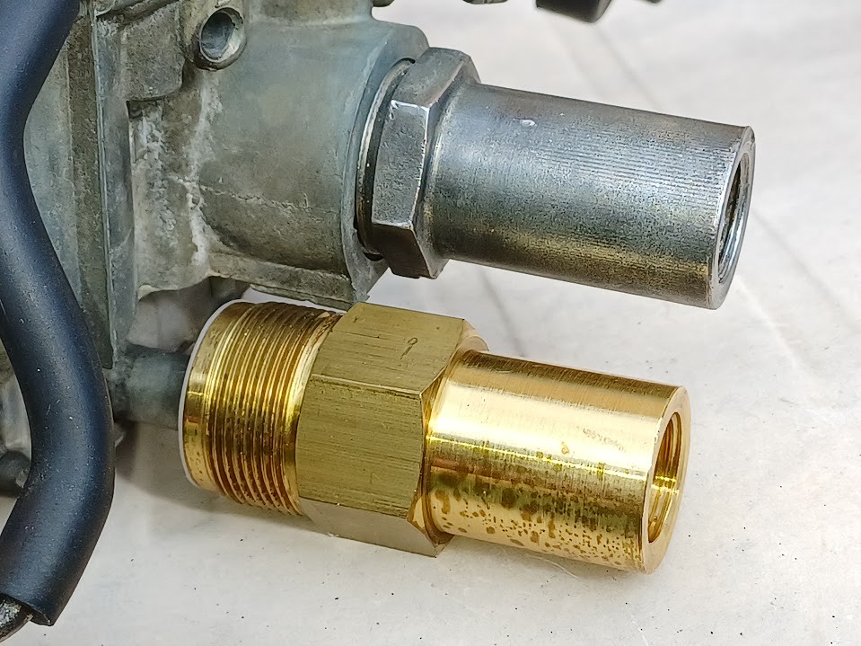

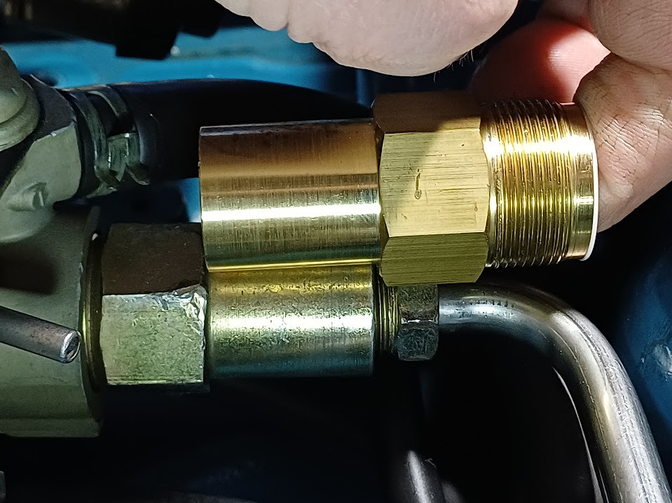

Recently released Oldsmobile (and some BOP) version of the long fuel filter housing for Quadrajet carbs. This is the extended nut version, there is already a longer version available of the short nut as shown on used Q-jet at bottom of this post.
To justify the postage expense, I bought several. Then found out they were brass, not plated like the originals. Not terrible, but also not original. They are nearly always dinged-up, and rounded off, so replate badly and highlight any damage more than used. These came with spring, seal and filter that were made in Taiwan. I'm assuming the bodies could be as well, they are unbranded and 2 sellers that stock these refused to respond.
I only compared by eye, they look good in proportions and machining.
Quadrajet brass filter housing repro (1) by Ben Noakes, on Flickr
Quadrajet brass filter housing repro (2) by Ben Noakes, on Flickr
Pontiac and BOP version that uses the shorter hex nut section.
Quadrajet brass filter housing repro (3) by Ben Noakes, on Flickr
Quadrajet brass filter housing repro (5) by Ben Noakes, on Flickr
Quadrajet brass filter housing repro (7) by Ben Noakes, on Flickr
