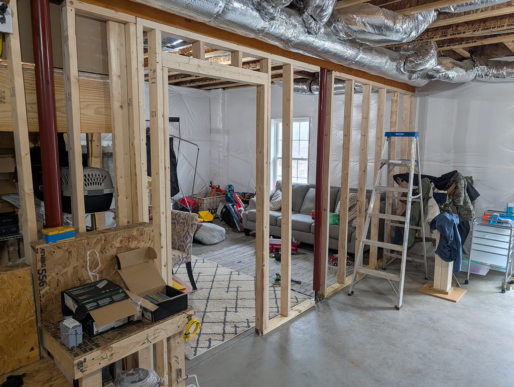

She's very understanding, but at the same time I have been busy with other home projects too. We're finishing our basement and I've been putting up walls so that we can build a guest room, full bathroom and a rec/living room for the boys to rough house in. Plus I build a 16x20 porch pretty much every spare moment I had last summer.  8)
So far, I built useable storage under the stairs by adding a door, framed up the utilities room and partially finished the guest bedroom. Working on the rest of the walls and planning out where I want to add outlets now. I can't sit on the couch after work, so I just stay busy until I go to sleep.  :cool:
