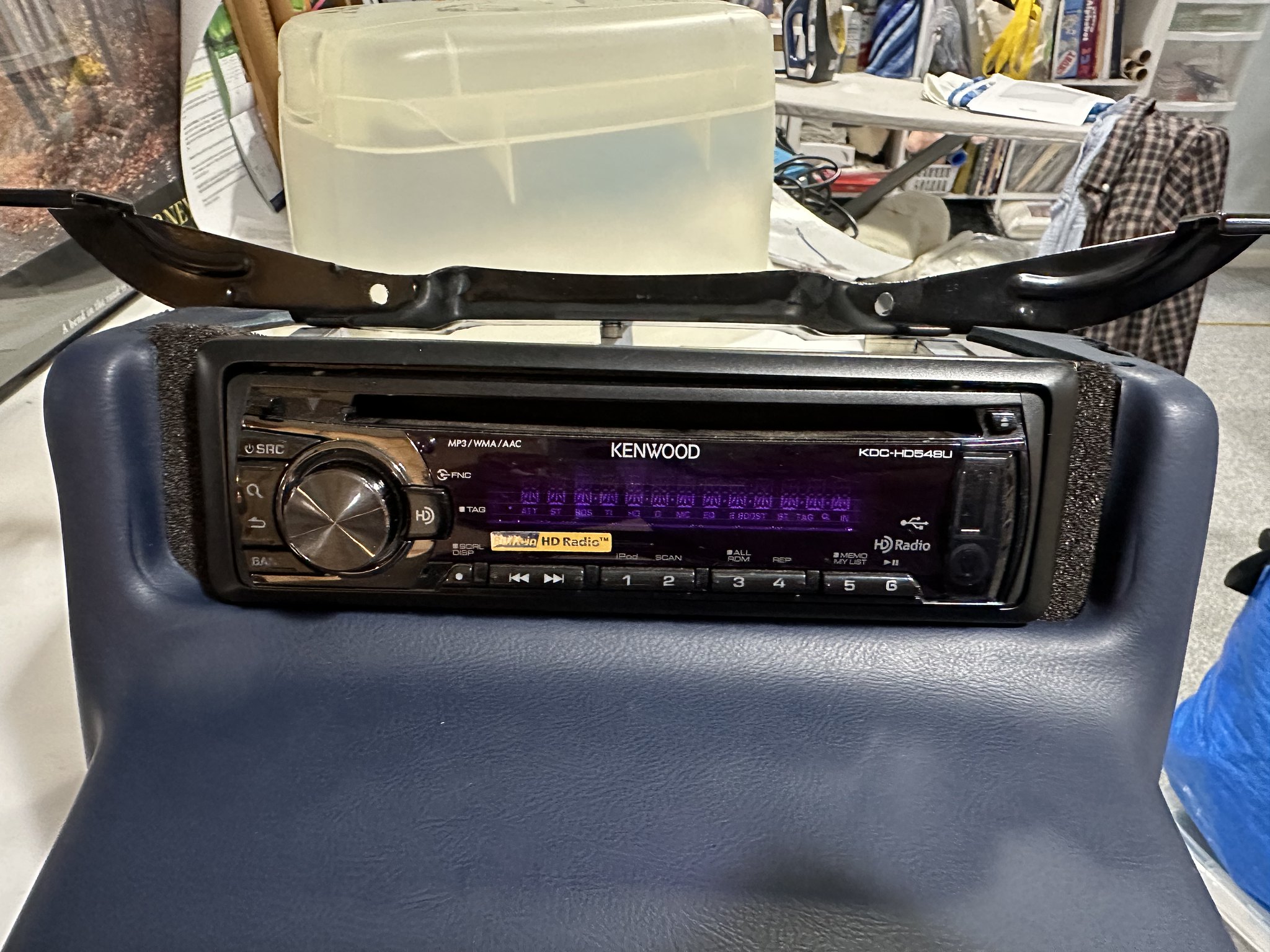

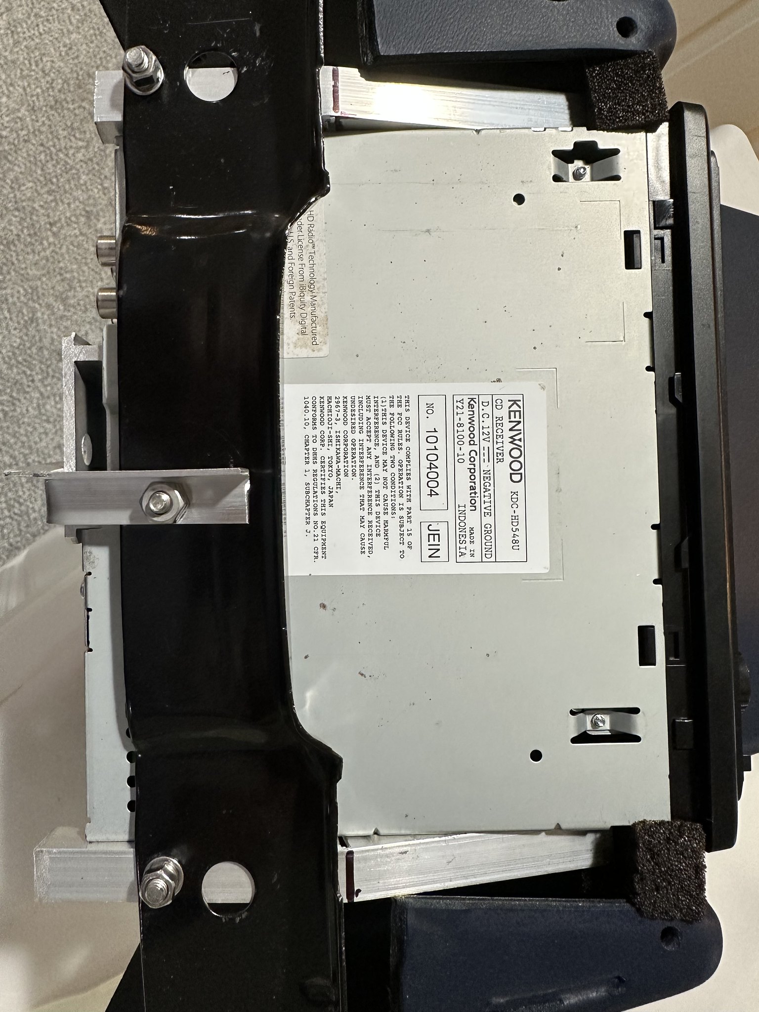

I remembered I had a 15-year-old Kenwood radio sitting in my basement and wondered if I could use it. I wanted to keep my car stock looking as possible, no cutting on the dash or doors. I was able to remove the plastic tray located under the ashtray in the console and mount the radio there. If I ever decide to remove the radio I can reinstall the tray. The radio is a Kenwood KDC-HD545U, Am, FM HD, CD player and USB port for external audio devices. I had to fabricate a mounting bracket using aluminum angle stock.
Radio mounted in console, had to drill three holes in console mounting bracket.
IMG_1037 by Lawrence Alexander, on Flickr
Console from the front. I used foam gasket to fill the gaps on the side.
IMG_1038 by Lawrence Alexander, on Flickr

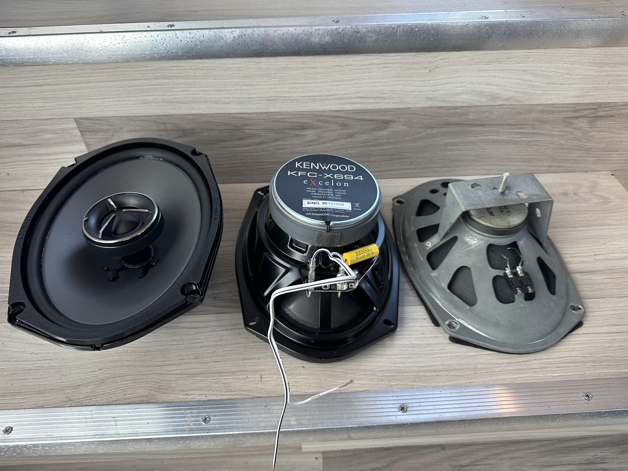

I ordered new 6X9 speakers from Crutchfield, Kenwwod Excelon KFC-X694 $119.99 for the pair.
New rear speakers compared to the old. I wanted to use my factory flush mount grills. The new speakers had a three-prong plastic trim at the top of the tweeter (far left speaker) that had to be trimmed so it would not hit the grill. If I would have used spacers to drop the speaker down the right-side speaker would have hit the tire jack mount and come really close to hitting the spare.
IMG_0970 by Lawrence Alexander, on Flickr
New front speakers compared to the old. The new front speakers had much larger magnets making them a tight fit. I had to rotate the left front speaker 180 degrees so the spade lugs pointed to the front of the car, otherwise they would have hit the back of the instrument cluster. The new speakers came with a filter to cut of anything below 800 HZ. When I tried to run without the filter low frequencies would over power them.
IMG_1005 by Lawrence Alexander, on Flickr
IMG_1006 by Lawrence Alexander, on Flickr
