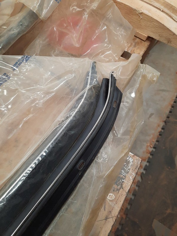

Everytime I read these threads makes me glad I bought 2 sets when they were still available from GM. Wish I had bought more now!
Larry, you may be on to something. The metal part is the base and what typically does not fit. If I recall the rubber is stapled and maybe glued on. I would do exactly what you say. Buy a new set, remove the rubber and install on the old hardware. I think I will try this with my 79 before I open one of the last 2 nos I have.

Not only do the aftermarket ones fit poorly, but a lot of prospective restorers end up garnering some degree of confusion over which cars came with which sweeps, and so they end up getting the wrong ones. Maybe a sticky should be made for it? I'll try to break it down.
The kind of window sweep your Firebird or Trans Am came with depends on what options it has. There were three kinds made:
Fully-blacked out sweeps with no chrome bead: These sweeps were only available on cars with the B85 chrome decor package, which implemented a SEPARATE very thick chrome applique along the top of the doors, a small piece to meet them on the top of the fenders, and across the entire hood. The reason the window sweeps were blacked out was because an integrated chrome bead was not necessary given the larger separate chrome applique that would come standard with the package they were used on. The B85 package was optional on all other trim levels sans Esprit, with which it was standard (and yes, that includes the Lady Birds).
Thin, round chrome bead window sweeps: These sweeps feature a small, round chrome bead around 1/8-1/10 thick and were only seen on Y cars (LEs, SEs, TATAs, Pace Cars, etc.) cars.
Flat chrome bead window sweeps: These sweeps were standard on any Firebird, Formula, or non-SE Trans Am model. They feature a flat chrome bead that is a little under a quarter inch in width. This is the kind that you'll see the most often.
If I'm inaccurate on anything, by all means let me know.

I just went through this azz pain. I tried OER replacements and they were crap stiff rubber and the metal attaching strip was not bent on the same arch as the door edge. All the complaints listed already.  For $48 I thought what the heck I'll try these from Summit:
Fairchild Industries Weatherstrip Seals KG2095
Part Number: FCD-KG2095
BINGO! These fit great, rubber sweep is soft and pliable, screw holes all lined up metal bend matches the door edge.  Summit had the cheapest price I could find couple months ago.
« Last Edit: September 22, 2022, 05:37:28 AM by silver78 »

Pic of Fairchild piece installed

original and Fairchild piece

Thanks for taking the time to provide this VAULUABLE information along with photo's. The moldings you show are the same as what my 1980 TA came with. Funny I have ordered a lot of parts in the past from Summit and never would have thought they would stock these. Current price is 56.99, plus shipping and tax. In my mind a good deal.

Good photos. I'm surprised you left it so long to swap that they were dried out and cracking. I have a set of the plain (suit decor molds) strips by FC, somewhere.

I bought a set of the Fairchild from Summit on the recommendation of Silver 78. They are darn near perfect. I compared them to the set of NOS (pictured in the bag above) and they matched spot on. They fit on the door perfect as well. I think they were something like $60 shipped to my door for the pair. Anyone needing a set of sweeps, these are the ones to go to.

I was super excited when silver78 came up with the suggestion of the Fairchild sweeps from Summit, so I ordered a set last week. Unfortunately, UPS was pretty rough on the handling. I was suspicious when I saw the box and took pictures before opening it up. Both moldings were bent and one the metal bead was bent. Other than the shipping damage it looks to be a quality part. The last photo showing damage is kind of blurry. I called Summit this morning and they have another set on the way.
IMG_0438 by Lawrence Alexander, on Flickr
IMG_0439 by Lawrence Alexander, on Flickr
IMG_0448 by Lawrence Alexander, on Flickr

I received my second set of Fairchild belt weather strip/sweeps from Summit this afternoon. These arrived intact without shipping damage. I installed the driver's side and I am happy with the fit and look. The only issue is I had to slightly twist the metal bead at the rear (near the door handle) slightly, so it did not rub against the outer door skin. After hearing the negative response about the OER part I would not hesitate to recommend the Fairchild part. I am also pleased with how quickly Summmit made good on the original part that was damaged in shipment.
The top sweep is the Fairchild from Summit, the lower is of the original. I had to twist the end of the metal bead on the Fairchild, so it did not rub against the paint on the outer door skin. Basically, bent it the same as the original part.

« Reply #39 on: July 10, 2023, 03:01:49 AM »
Just received Fairchild window sweeps. The curve on the inner sweeps is not correct and I was a little bit disappointed at first. Then I realized that the original is not better at all. They are almost the same. I'm making my own door panels and will fix that. I'm gonna use old upper plastic portions which were broken in hundred pieces. They definitely need to pay more attention on packing cause the box was also damaged, but luckily the sweeps survived. I'll check the outers later.
Fairchild compared with old factory sweep
