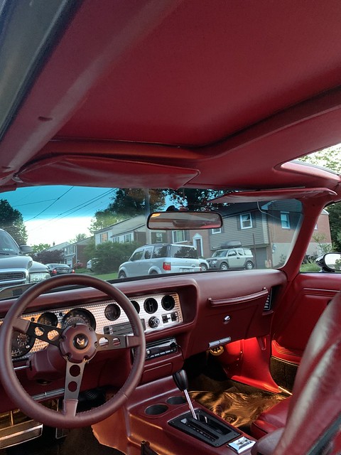

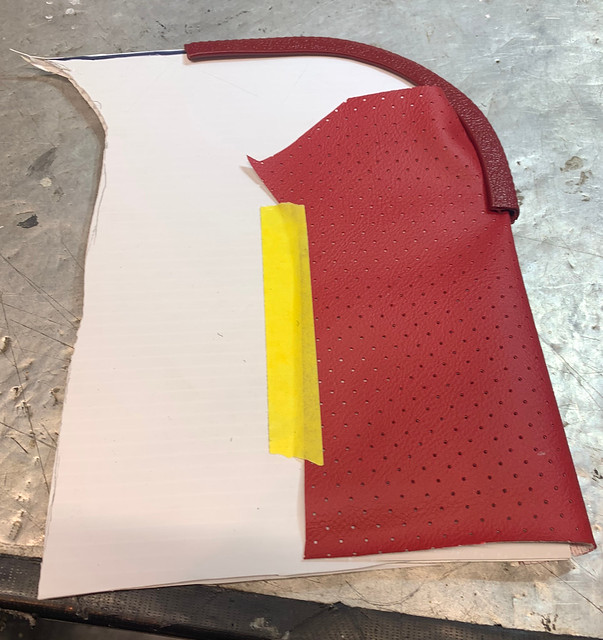

I made these shades using 'Plastic cardboard' (Curragated plastic) board as the base, leftover headliner material, Red interior 'Windlace' (Classic Industries PN: T5DKRED), some black adhesive-backed vinyl, and a couple of pieces of heavy-duty adheasive-backed velcro.
Here's the basic setup:
T-top shade mock up by Tom Sherer, on Flickr
 We covered the side facing up with the black vinyl.  Then, we used headliner adhesive to cover the inside with the leftover headliner material.  The windlace was then wrapped around 3 sides to make finished edge covering where the headliner material wraps around.
TA T-Top covers by Tom Sherer, on Flickr
When installed, the 4th side (with no windlace) slides in between the interior garnish molding and the glass.  The other three sides rest upon the interior T-Top trim pieces.  There's enough space, and enough of a lip between the glass and the top of the interior trim to hold the shade up. And, the snug fit between garnish molding and glass holds it tightly.   The only problem with this set up was that it was a little awkard putting the tops on and off and sliding them into the storage bags with the shades installed.  I put a couple pieces of heavy duty velcro on the shade's top side and T-Top glass to hold the shade so that I can easily install, remove, and store the tops with the shades installed
The interior temps remained consistently cool (head to toe) and comfortable in Mid-day, Mid-June, 95+ degree days on the tour.  And the TA made it all the way to FLA and back, no problem...

Sunvisor bracket by Tom Sherer, on Flickr
...solved the long running sunvisor nuisance.

While working on cleaning up the T-Top weather strip rail area for paint, I was in close proximity to the headliner.  I noticed it had started to sag!   Right in the middle, above the back seat!  UGH!
 1/2 the interior is out already so we pulled the headliner out and found this...
Untitled by Tom Sherer, on Flickr
It wasn't the expected adhesive failure causing the droop.  The actual ABS plastic backing board had warped!
So, I had to take the whole thing apart...
And now I'm waiting on a new backing board and foam so that I can re-make my headliner. awesome.
