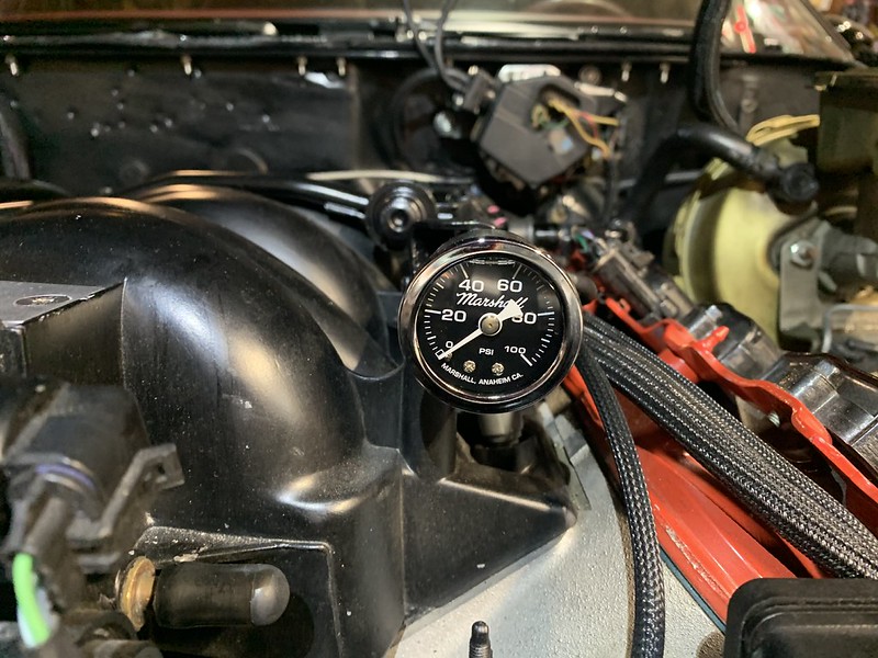

The other contributing factor was the fuel pressure gauge I had installed on the fuel rail...
 Similar to the super cheap fuel injector example above, for the "You get what you pay for" file:
 I had installed a cheap 'JEGS' brand fuel pressure gauge on the fuel rail during a previous fuel system troubleshooting go-round immediately during the initial engine shakedown. The JEGS gauge was showing 60+ PSI while running.  As noted in my prior post, after taking everything apart I realized this gauge never zero's out.  After taking it off the fuel rail it still indicated around 12 PSI.   My new Marshall fuel pressure gauge showed 40PSI when we initially fired the car up with its new injectors installed.
IMG_5858 by Tom Sherer, on Flickr
I could hear the idle clean up as I adjusted the pressure up to 60PSI on the new gauge.  And, as noted above, the car was running great today.

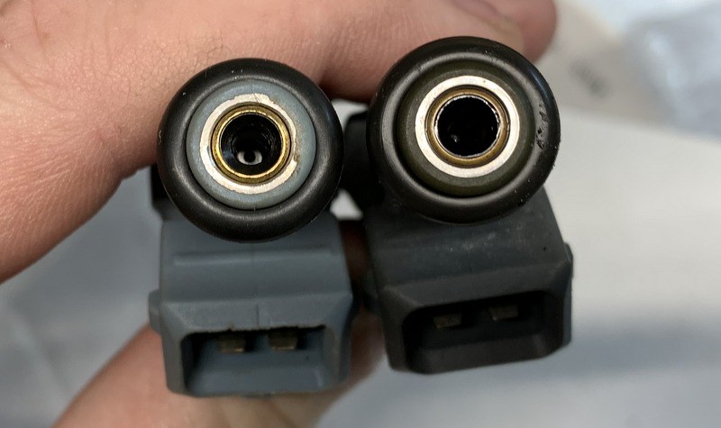

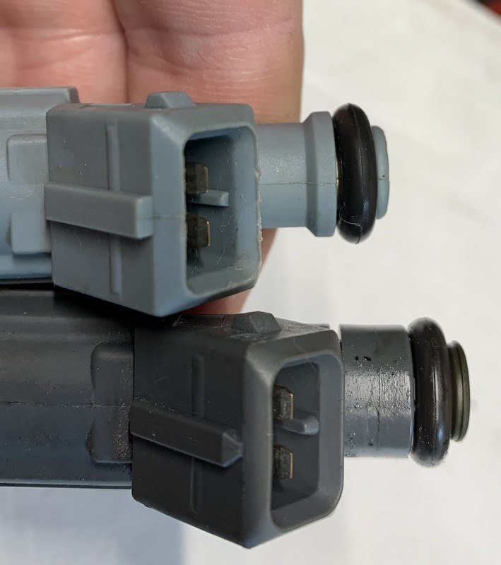

I wanted to show you guys the cheap fuel injectors I decided to return for the remanufactured ones.  These were $22.00 ea. @ PartsGeek compared to > $70.00+ for new ACDelco 12456154's elsewhere.
The lack of English on the box (except for the giant 'Made in China' sticker) was the first thing that made me raise an eyebrow.  But...I think this is German...Germans know engineering and manufacturing...
IMG_5876 by Tom Sherer, on Flickr
So I had a closer look. I immediately noticed that these felt lighter, less weighty than the ones I took out.  Aside from how they 'felt', the plastic housing had rough edges compared to the ACDelco part. Here you can see the unfinished edges around where the plug goes:
IMG_5871 by Tom Sherer, on Flickr
And, the finish of the bottom plate looks 'rougher'...Less precise in how it was put together:
IMG_5872 by Tom Sherer, on Flickr
And I'm not sure what this white ring around the top inlet is...But look at the cheap one on the left compared to the used ACDelco part on the right:
IMG_5873 by Tom Sherer, on Flickr
These might perform fine, but I thought a quality refurbished set might be more reliable. The ones from InjectionConnection come with a 3yr. warranty and (@ around $40.00 ea.) they split the difference in price between the apparent Knock-off's shown above and brand new name-brand injectors.  We'll see how they work out.

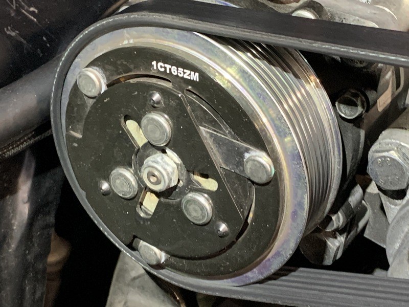

Anyway...On to my current issue...The Accessory belt problem:
The belt keeps moving forward over the edge of the AC compressor pulley like this:
IMG_5865 by Tom Sherer, on Flickr
I didn't change anything over there on the AC Compressor bracket this winter.  And, this wasn't a problem last season.  Initially, after I noticed it the belt would jump over immediately after being put back in place.   I knew the tensioner was always running near the minimum of it's travel.  So, I installed a new belt....No changed.   Then, I thought a smaller belt, getting the tensioner more in it's intended range might help.   That seemed to help.  But, eventually it ends up back over the edge.
I didn't notice any unusual play or 'action' in the AC Compressor pulley, the tensioner pulley, or the idler there.  And, the seemed to be aligned OK.  But, after seeing these pics I double-checked with straight edge and the tensioner is definitly forward farther than I think it should be....

Maybe try adding a flat washer or two behind the tension pulley to shim it out towards the rad a bit.
Re: 1981 Turbo Trans-Am Project
« Reply #44 on: April 29, 2021, 05:49:27 AM »
That tensioner is definitely the issue. It looks like it's bent out of shape somehow? Maybe it's worn out internally or something because it appears to be bent in a way that is pulling the belt off of the AC unit.

Thanks for the input guys.  I appreciate it.    It's a little strange that I didn't see the misalignment while eyeballing things directly.  When it's seems so obviously out of whack in the pics.
This AC mount bracket is a Qwik Performance part from Vintage air.  The compressor, idler, and tensioner are all mounted on the bracket together.  The way it's put together there's not much room for trying to shim or adjust things.  I'm going to TN this week, so I won't get to mess with it again until next week.   Because the part is relatively cheap I decided to order a new one now so it'll be here when we get back.   I'll throw it on and we'll see what happens.

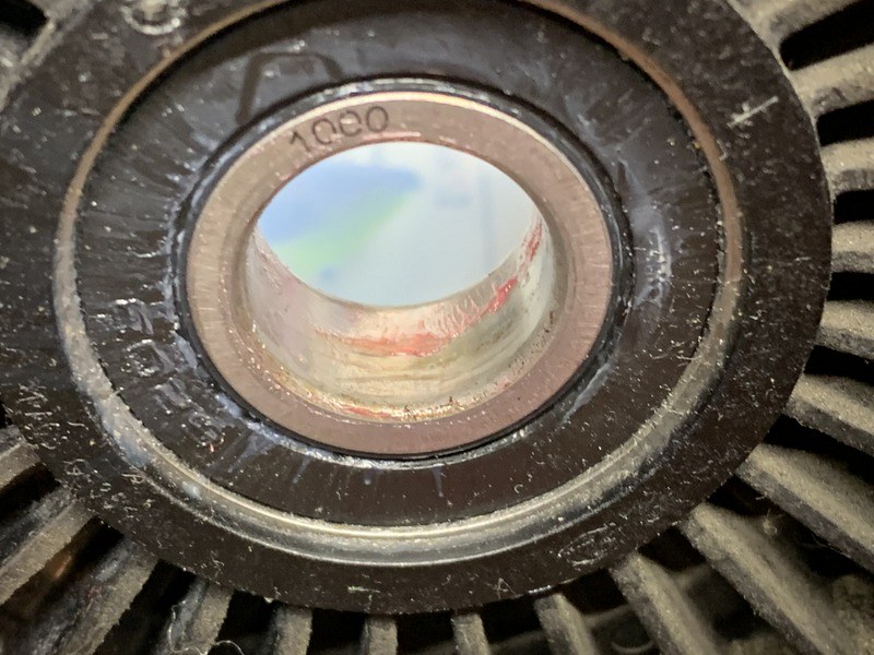

Julie and I got into the Accessory belt issue and, Well...I'm reminded once again that I'm an amateur at this stuff...
We pulled the pulley off the tensioner and it was immediately apparent it was failing.
It looked like the bearing surface was discolored, which I think indicates overheating...
IMG_6029 by Tom Sherer, on Flickr
IMG_6030 by Tom Sherer, on Flickr
And look at the front edge of the tensioner itself where the pulley rides...it's all torn up...
IMG_6031 by Tom Sherer, on Flickr
Curious.  How/why would it start failing like that?
We found out quickly when we went to remove the tensioner from the AC bracket.  The top bolt attaching the tensioner to the bracket was loose.  Ugh!   I thought I checked all of these when I first heard that smacking sound. Apparently, I missed the bolt that hides behind the pully.
Another self-inflicted wound and another lesson learned this winter.
At least it should be an easy fix.

I Went out this evening to put a couple miles on the car.  Fired it up and it immediately ejected the accessory belt on to the garage floor!
WFT is going on!?!  This is getting frediculous!
Long story short...I happen to have a second, new tensioner on hand.  The first new tensioner I installed is apparently defective.  It doesn't have as much travel as the second new tensioner?
The second new tensioner seems to be holding up...for now.
I'm sure that'll be the last issue for a while.  LOL.
