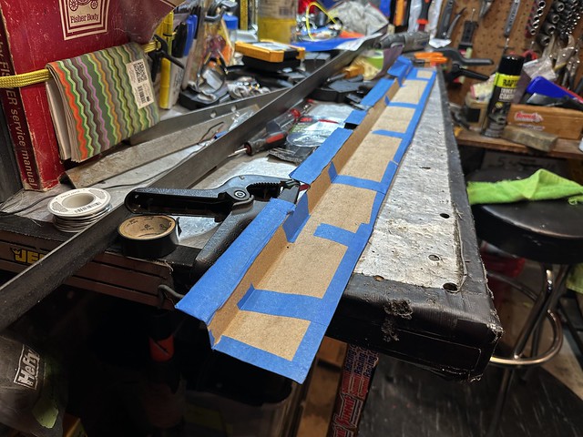

My mounting solution is a fail...
The light itself is just a universal 35"  "Red Car Third Brake Strip Light - Flexible High Mount Stop Brake Light IP67 Waterproof & 108pcs Lamp Beads" It's an LED strip essentially encased in a rubber housing.
Mounting it like I want, requires a shape like this...
Untitled by Tom Sherer, on Flickr
The top (with the cut-outs slides in the rear headliner trim.  The vertical piece is where the LED strip mounts w/3M dble sided tape.  Then, the bottom flat piece covers out to the window (To control the Light out the back window and keep it from just lighting up the whole back seat.)
My initial attempt was to make that shape with some sheet metal.  The problem with that was that the mount needs a crown in it long ways across, to match the shape of the roof.  Once the metal is bent to the z shape, it wont bend that way (at least not without the appropriate metal working tools (and skills for that matter).
I decided to try making the shape by heating and bending some 1/8" FRP plastic sheeting I had laying around.
After a bunch of attempts to figure out how to work with the stuff...
I ended up with the setup I showed earlier...
Unfortunately, working the plastic with heat I ended up with an unstable shape that seems to have some 'bad' memory.  After a few cycles of sitting in the sun, then cooling it lost its shap across the bottom. You can see how it's no longer straight across on the part that goes back to the window...
Long story short...I'm currently working on a new solution, using three pieces fo FPR (instead of heating and bending one piece).  Then, using epoxy to stick them together.   I think I this method is gonna work.  The problem I'm having now is getting a nice finished look to the whole contraption.
This whole exercise is worth the time 'cause of the piece of mind the extra visibility is giving me.

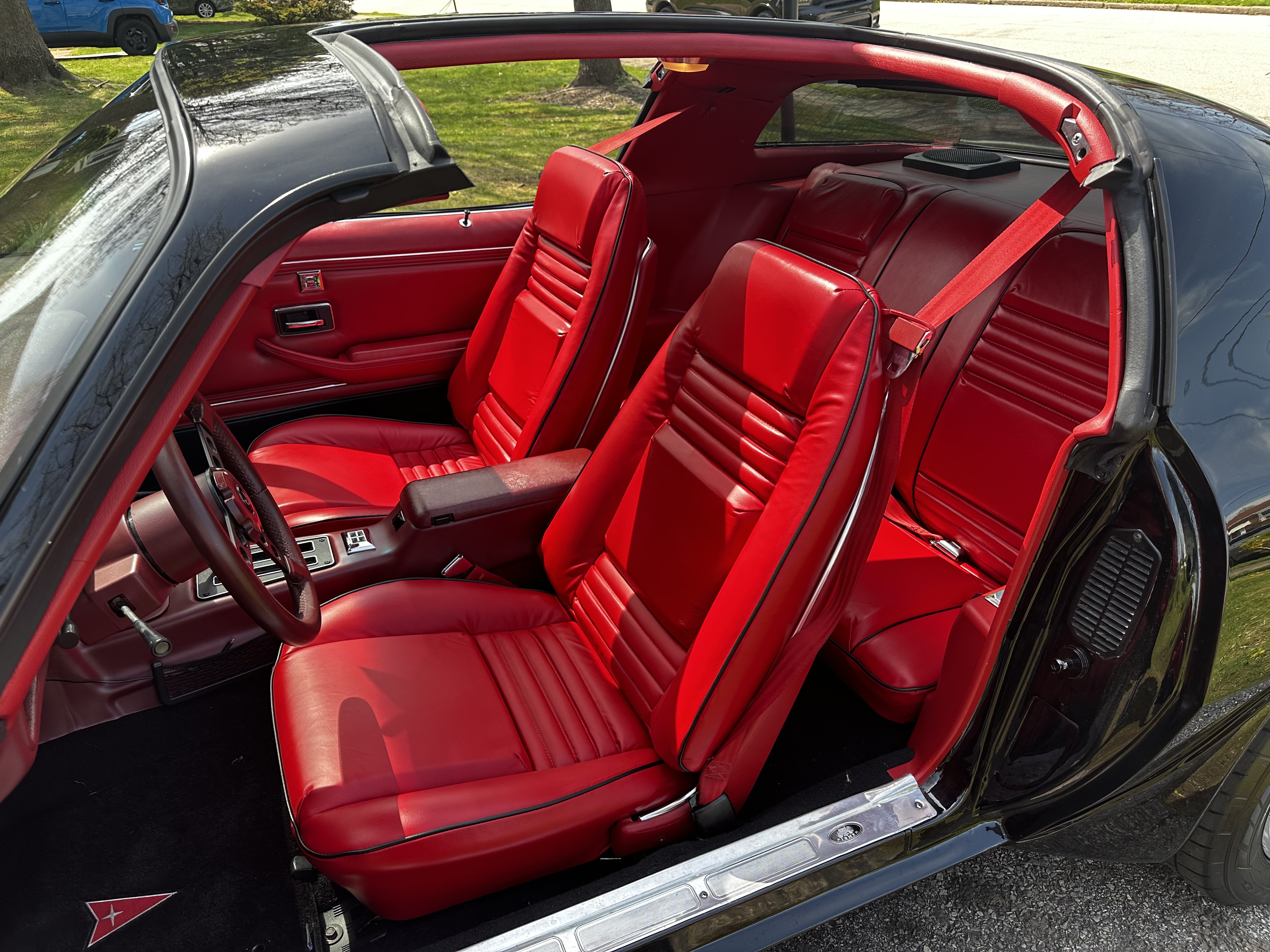

The biggest off season project we had was redoing around 85% of the interior.  Replacement interior  parts from the accident did not match the stuff we refinished 4 or 5 years ago.  So we pulled all the hard plastic out…
Cleaned prepped, and painted everything…
While everything was out we contacted Legendary Auto Interiors about the leather.  The seat cover leather had a painted on dye that was failing.   It was wearing funny and cracking with natural tan color showing through
Legendary stepped up and replaced all the leather under warranty.  I don’t have any really good pics, but the new leather looks more modern, less old leather couch.
I’ll get some better pics of the new stuff…but that pic reminds me…We also installed a new shifter plate ‘cause the silver chrome stuff wore off.  Here’s the new one.  I sprayed a clear coat over it to hopefully make that chrome highlight edge last more than 3 seasons
