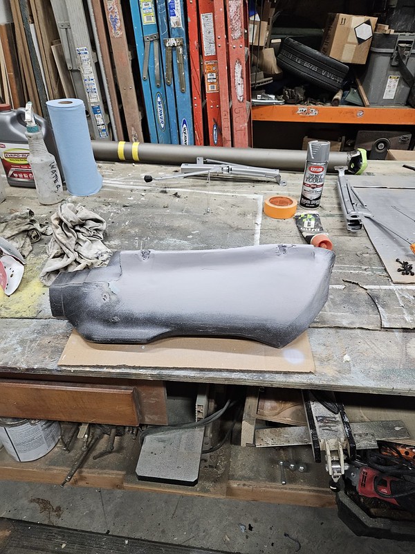

Under dash duct had a hole in it patched up with duct tape. I had a few free minutes so I figured I would try to fix rather than get a new one (I looked on Franks website and they have nothing currently). I thought I had a full set of duct work but after a search around the shop I came up empty. Fortunately the pieces broke off fell inside the part so I was able to patch it back together and then I fibreglassed over. It was kind of messy, so I followed up with some flex filler, then fillable primer from Rustoleum, then some rustoleum satin black. I then used SEM clear satin on top. I was surprised the SEM didnt react with the Rustoleum. Its not perfect but once its tucked up under the dash I think it will be fine.
20240427_121156 by Kerry Grubb, on Flickr20240427_140929 by Kerry Grubb, on Flickr20240427_140929 by Kerry Grubb, on Flickr20240428_173138 by Kerry Grubb, on Flickr

Nice job on the AC duct. It should be good for another 45 years, maybe  more.

Awesome job on the heater duct repair.  The whole project looks to be coming out great!

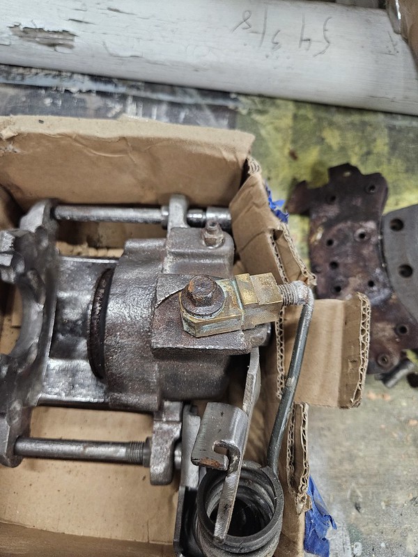

Front brakes all fine. I could not get a vacuum on the back to save my life. After a few unsuccessful tries I decided to check that my fittings were tight. I DID NOT HAVE THE MAIN LINE HOOKED UP TO THE SPLITTER AT THE REAR END :shock: :sad: :mad:
So, hook that up and still no vac. Trip 2 lets look at the fittings again. The line input to the caliper was nice and tight, however the line moved freely in and out of the caliper, like it was missing a stop/washer ferule or something? With some advice and looking around I could not figure how to remedy the situation without a complete hodge podge. I called FbirdCentral where I bought the calipers (years ago now) and found they are for someone doing a disc brake swap onto a drum car. The fitting is accomplished with a banjo bolt and flex line much like the fronts. Rather than going through a bunch to make things jive, I found a set of rebuilt original calipers and placed an order. Hope they work!

Rear Brake saga continues. I got a set of 'rebuilt' calipers (not cheap) but they are basically the same thing as I bought from firebird central. They are NOT originals rebuilt but a replacement. I still have the same problem, getting the line attached to the caliper itself. After getting some pictures in another thread from a kind member here I can finally see the problem. There is as described in the service manual a 'block' that attaches to the caliper with a banjo bolt that the brake line threads into. THIS is the part I am missing. SO, I started to think about it and I can vividly remember tearing my original caliper apart and refinishing it, I even bought a rebuild kit. I found the rebuild kit but no idea where the caliper is after an exhaustive search. I figure, 'hey, I might have made a post about rebuilding the caliper  :???:'. I went back to page one of this thread and BAZINGA, right there on page 2, dated June 16, 2021 is pictures of the rear caliper before and after a cleanup. NOW ALL I HAVE TO DO IS TEAR MY SHOP APART TO FIND IT. I never throw any car part away, I cant imagine I would have gotten rid of this.

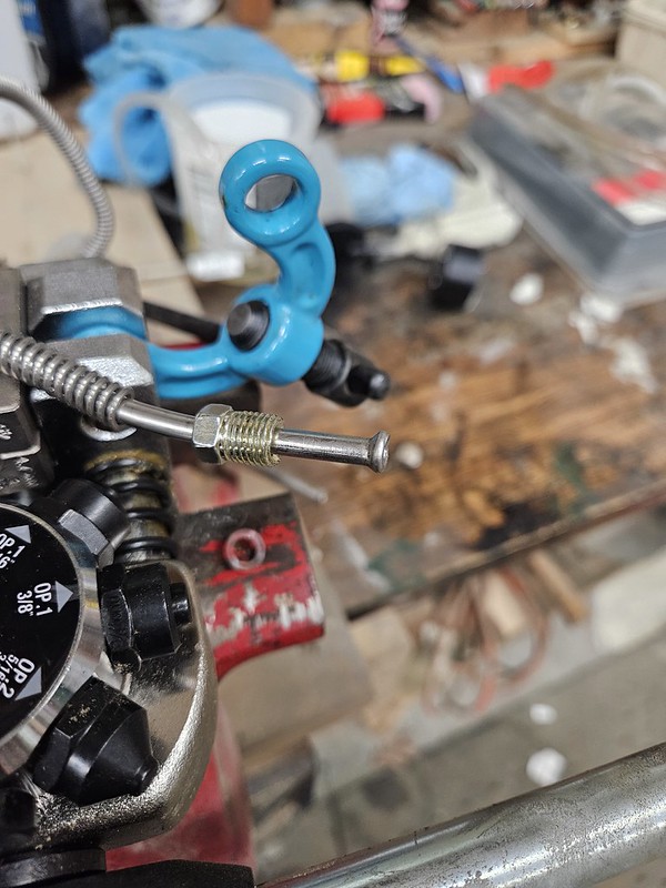

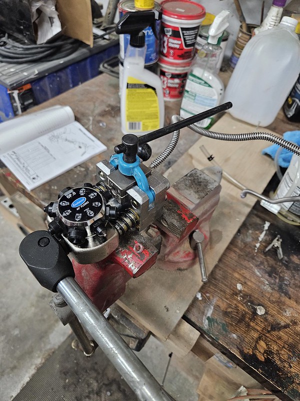

After digging through every box I had in the shop, and thats a lot :shock: I had given up. I knew I did not throw them away but got to the point that there was nowhere else I would have put them. THEN, I saw my flare kit peeking out on the corner of the shelf. I wondered, is there a chance................?  I have looked over that spot multiple times during my search as I KNEW the only thing there was my plumbing and electrical tool kits. However with all other spots coming up empty and nothing to loose there IT WAS :grin:
Got the block off, and of course the fitting on my brake line was not compatible. Luckily I had one in my pile of parts, got the flare kit out and new end put on. Got everything hooked back up on the car, gave the bleeder a few minutes of pumping with my vac tool but wore my hand out (minor case of arthritis) so I will get some help today to do some pushing on the brake pedal. Hopefully that will be quicker and easier.

Nicely done Kerry, I knew you would find them. In your quest for the calipers did you find anything you weren't looking for? Gold nuggets or a valuable baseball card? It seems whenever I am searching for something, I find everything but what I am looking for.
You are getting close to having a driver. Many years ago, when I was doing my 19975 TA, I slowly drove it up and down the alley without doors, hood or a front clip. All it proved was it could move and stop, but I was excited anyway.

I did find a lot of stuff I either forgot or didnt know I had. When I bought this car it was literally packed full of boxes of trans am parts. I was joking with my son the other day that I should get a spot at Carlisle and sell it off. I found a lot of fasteners I did not know I had, some of the small parts I will be needing soon as well. I organized a bit, and took the stuff I think I may need and put it in one box. I am not a seller, but I really should do something with all I have. Once the 79 is finished I may do a purge.
As for driving, I have 2 sets of seats (did I mention the car came with a lot of extras :shock:) and I put a black hobnail in there temp. The TATA seats are shredded wheat, not toast. Once I get the brakes straightened out I hope to put the front sheet metal back on. At that point hopefully it will be a short time before I can take a spin around the block. I have all of the interior except the seat covers. For the last couple of years I have been waiting on Legendary to have a sale. Its about to the point that I need to pull the plug and get them ordered. It should be the last big expense to get this car finished. When I did my 77 it was 99% finished before I put it on the road. With this one as soon as I am at a point that I can get it insured I will get the tags.

I have the same flare tool, but I haven't used it yet.  I hear they are pretty cool.
« Reply #498 on: May 08, 2024, 03:05:47 PM »
Yes I was beginning to wonder if I had given/sold them to someone. The flare tool works pretty well. This line was stainless so it took a bit more muscle, bends like a breeze with the nicop.

I have been struggling both physically and mentally with my brakes. After exhaustive searching I finally found the correct banjo bolts from an online supplier of brake fittings. These parts replaced the brass block that is on the stock brakes. Unfortunately the fitting I had on the hard line I had already installed in the car was not correct. So, I had to take that off and put a new fitting on. THEN, the fitting that came with the new banjo bolt was correct in thread, but it was too long on the end with no threading. There was not enough to seat into the banjo bolt. So, back to cutting the tubing and putting a correct fitting on. After changing the line twice, and replacing the fittings a couple of times I finally got it!!
20240507_182203 by Kerry Grubb, on Flickr
Original brass block for brake fitting.
