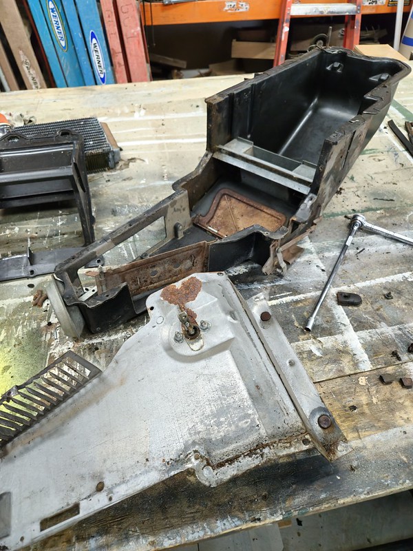

Took the heater box out tonight. Wasnt too bad, as long as I remember how to re-install :shock:
It was a blessing in disguise as the inside was home to the traveling rodents at some point. It was pretty messy, grimy and rusty. Got everything cleaned up, some repainting done and some re-assembly. Waiting on some paint to dry and the core to get here. Hope to have everything back in place over the weekend.
20240409_164312 by Kerry Grubb, on Flickr20240409_165226 by Kerry Grubb, on Flickr20240409_165235 by Kerry Grubb, on Flickr20240409_172515 by Kerry Grubb, on Flickr20240409_180316 by Kerry Grubb, on Flickr20240409_182020 by Kerry Grubb, on Flickr

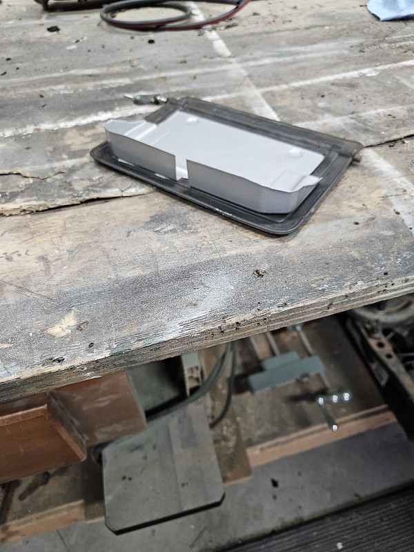

20240411_200634 by Kerry Grubb, on Flickr20240411_200310 by Kerry Grubb, on Flickr20240411_200228 by Kerry Grubb, on Flickr
Heater box is finished! Metal was derusted with a combination of roloc, and evaporust, then hit with silver paint. I cleaned all of the hard plastic with simple green. That did a great job. I did a thorough read of my service manual and have a pretty good idea on how all of this is supposed to work as far as which door opens when and what makes which door open. The under dash was pretty nasty underneath all of this so I will clean and organize that mess before I install. Prob will keep me busy for a couple of hours this weekend.
The new heater core is aluminum. Not sure how that translates to efficiency over the copper but Im not worried about it. The core itself side by side the original looks very good. And the money I saved can go towards something else (seats?)
