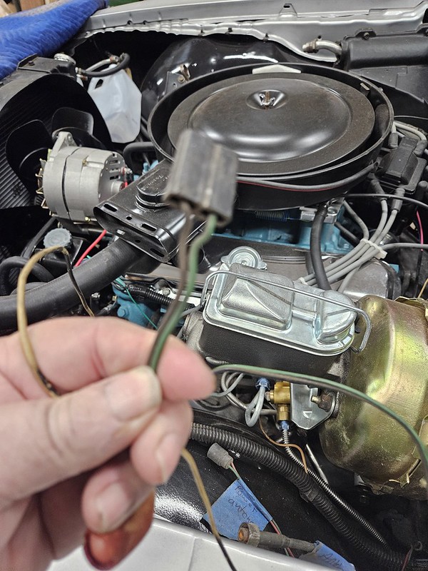

Trying to get things buttoned and I found these two wires. They were mixed in with my power ant. stuff so I overlooked them the first time around. I am pretty sure they are not for the antennae. There are 2 that come through the firewall at one location. One has a connector, the other has a bare end but that means nothing. I would only assume the connector has been lost over the years.
20240810_135623 by Kerry Grubb, on Flickr
This is where they come through the firewall20240810_135620 by Kerry Grubb, on Flickr
Here is the white wire, it has some kind of 'block' inline.20240810_135616 by Kerry Grubb, on Flickr
Green and brown with the connector in place.

I think the white wire is from tachometer and the wires with connector are for pulse wipers.

White one is for the tach.
The two wires you have I don't find but here is a pic of the connector going into my non-pulse wipers.  It comes from the top of the main fuse block in a wire loom.

OK. I was thinking the white wire was the tach. Glad to find that as it was not working when I started the car. Pulse wiper option so that is entirely possible. However the three wires I posted do not go into the wiring block on the engine bay say of the firewall. I bought a new engine harness and all of the engine wires go through that block. These that I posted are separate. I did not look but I assume they go directly to the fuse block.

Willie, grab one of these and swap the end. Make it look better and not risk coming off. Random link.
https://americanautowire.com/en-au/products/gm-hei-tachometer-connector-500205
The green one almost looks like a compressor plug, but a long way from home. Did you say they weren't for the power antenna? That's what I'd have guessed first, 3 wires and grommet in that location, although the electrical diagram say black, white and something else not as shown. 2 wires for aerial motor, one for the radio reception. You may be able to follow that one through to somewhere since it would bypass fusebox etc.

I am about 80% certain the two wire connector is not for the power antennae. I have those wires located. I marked them clearly when I unhooked it. The motor was out of the car and these wires were danglers when I got it, hence no location marked on them. I have a new tach harness for my 77 and it also has the same settup. A single and the 2 into one connector. The catalogue says that 79 requires a different harness so I bought one of those. I probably could have just put an end on the wire I have but its too late as the new part is ordered :shock:
