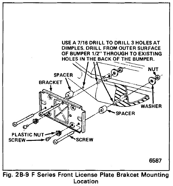

76-78 front license plate mounts. Good pics.
#525657 are the long bolts. 1/4" x 4.75".
#500519 are the angled rubber spacers.
Although, officially they are "license plate brakcet mounts"
Firebird 76_78 license plate mounting front by Ben, on Flickr
« Last Edit: September 27, 2023, 07:46:11 PM by Wallington »

Thanks Ben.......That explains it.
The front license plate holder was also in that box of front end parts.  It's been a long time ago since I've seen some of these parts.

Great info. I think mine is just screwed to the bumper. The way I got it. I knew it wasnt right but it worked.
