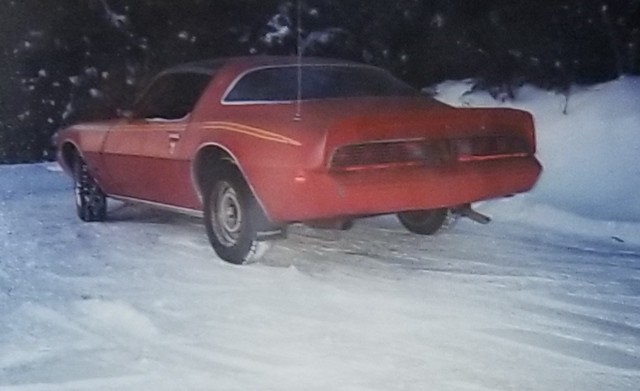

This is Ruby, formerly known as "The Project"
2021-01-08_10-24-31 by Charles Marson, on Flickr
20191209_081138 by Charles Marson, on Flickr
20191209_081356 by Charles Marson, on Flickr
20191209_081017 by Charles Marson, on Flickr
I picked her up in September of 2000, drove her illegally to my grandfathers place a month later and ripped her apart. I was going to restore her in less than a year, with no full time job, and done in time for my wedding (first marriage) the following August.

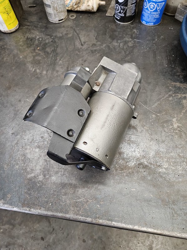

Well, since the last post, I am still working on restoring the water pump housing as the aluminum was really pitted on both units I had and I'm thinking it's from people using non aluminum friendly coolant.
I have also cleaned up all the casting flash and wire brushed all the surfaces on the block, and soon I'll notch the top of the cylinders to aid in exhaust gas removal. Everything was coated in WD40 to keep the rust at bay until I can get it cleaned and painted.
2021-04-29_10-11-11 by Charles Marson, on Flickr
2021-04-29_10-11-01 by Charles Marson, on Flickr
DISCLAIMER!!
What I have decided to do with this build is not the most popular way to refresh an engine, and I'm sure others will shutter but with that said, too bad, get over it...lol
Also, I am not building this for maximum power, or racing of any kind. I won't be thrashing the engine so for now, this will suffice and will likely work well unitil I can do it up right.
This is a super budget refresh build so I saved money where I could (like machine shop work) and purchased parts that I could find at the cheapest possible price. Also I am not replacing the rings, crank bearings, lifters and anything else that was working just fine before I pulled it apart.
So with that said, I purchased new connecting rod bearings, to install which will wear prematurely because of the scratches in the crank/bearing surface but It should hold out ok until I can rebuild this properly and at that point, I will purchase some better quality parts that were recommended to me.
Due to rusty push rods, I replaced those and also picked up a new, budget friendly timing chain set. A new pickup screen for the oil pump, frost plugs, temperature sensor, exhaust manifold studs, fresh fuel tank pickup screen, indirectly related to the engine and some shiny rocker cover tabs to spread out the tension from the bolts were also purchased.

I was able to get some work done sooner than expected and I took some pics of what I've been up too.
Starter Before:
Bosch Starter - Pontiac 301 by Charles Marson, on Flickr
After:
Bosch Starter by Charles Marson, on Flickr
