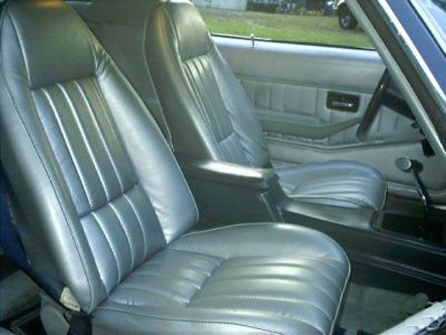

I have an 81 trans am with a standard silver interior.
Picture from tranzam.com
[/URL]
I have been redoing the silver interior panels with medium gray SEM color coat.  What I have been trouble figuring out is what color the dash and console are.  They seem to be a real dark blueish gray.  Or could they have originally been black and are just faded to this point?  I have never come across another silver interior car that was not a tenth anniversary and If I remember correctly they are more of a silver/gray in color.  I appreciate any help in advance, otherwise I will make my best (un)educated guess.

There's a code 15 Dark Grey interior trim, different codes for low gloss or semi gloss.

Just as an fyi the SEM colours for the Tenth are 15393 Med Gray for the dark (console and dash) and 15183 Warm Gray for everything else. I have a couple of SEM charts and there are multiple grays, just not sure which are compatible with Pontiac.
