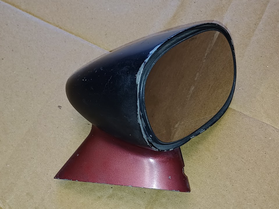

You'd think it couldn't happen twice...
Let me introduce my latest mystery mirror! This was sold as the typical '70-81 Firebird/Camaro RH mirror, clearly made up of 2 different mirrors, plus it had almost perfect 50 year old glass. And no, I didn't need any of those things, it followed me home.
RH GM door mirror 11-3 Firebird X-body support 52832 Pedestal 29845 plastic backing 32374 9870948 (2) by Ben, on Flickr
Straight away I noticed that the mirror glass barely pivoted to the right. It also sat almost flush due to filling the head opening. It is a late-'73 glass so I guess that perhaps the black head was the slightly smaller '70-72 mirror version that used 5-1/8" glass instead of later 5-1/4" glass. No! This one actually has 5-1/2" glass and the backing plate has a casting number I don't have record of. I'm not sure what the later A/G-body cars with larger stud-mount mirrors used for glass. Having said that it's 1973-dated so rules that out. Corvette? The backing plate is casting 9870948, can't currently read the pedestal casting, perhaps after cleaning.
Unknown 5-1/2" glass.
RH mirror glass 11-73 5-5jj by Ben, on Flickr
Standard 5-1/4" '72-81 F-body glass.
RH mirror glass 10-72 5-25jj by Ben, on Flickr
The next issue, which was actually what I noticed unpacking it is that yet again it has the square-cut support. It looks to be another X-body support. The casting number 52832 again comes up blank in my records. Here it is against the typical lean of the F-body support 29845.
RH mirror supports 52832 X-body 29845 F-body (1) by Ben, on Flickr
RH GM door mirror 11-3 Firebird X-body support 52832 Pedestal 29845 plastic backing 32374 9870948 (11) by Ben, on Flickr
As shown before, the X-body support has a longer base footprint than Firebird, and likewise gasket to match.
RH mirror supports 52832 X-body 29845 F-body  (4) by Ben, on Flickr
Then the last mystery, the head casting is actually the same length as the Firebird sample I pulled down to compare with. But then, the new casting is actually taller which I haven't seen even with those that differ slightly. Annoyingly, half of the casting number is ground away so reads 323xx. You guessed it, doesn't match any partials I have in records. The date code casting is very faint, most likely '73, like the glass that didn't come from it.
RH mirror head height differnces 35013 vs 323xx (4) by Ben, on Flickr
So after all that, not really sure what any of the 3 main parts actually started on. And more importantly, can't sell to get money back either. Good times.
I'll strip the paint and see what else pops up. With a slightly smaller glass and internals swap it could end up being fairly rare RH X-body mirror combination. Or perhaps the limited travel in the glass works in the favour. Does anyone actually want a set of those, apparently not.

Stripped it all down. Not many new details to add. The head casting is definitely 1973.
RH X-body mirror bare castings 1973 (1) by Ben, on Flickr
RH X-body mirror bare castings 1973 (27) by Ben, on Flickr
Can't do this with a Firebird mirror.
RH X-body mirror bare castings 1973 (2) by Ben, on Flickr
It's a shame, because the glass is really nice for 50 years old. This shot shows how much it fills the head casting.
RH X-body mirror bare castings 1973 (23) by Ben, on Flickr
Then as a comparison, this is fully pivoted to the right, almost not at all.
RH X-body mirror bare castings 1973 (21) by Ben, on Flickr
And fully pivoted to the left. Perhaps that matches the vehicle used depending on seat vs mirror location. No idea.
RH X-body mirror bare castings 1973 (22) by Ben, on Flickr
Something else I didn't notice until later because I simply tossed them to one side, were a few extra parts that came with the mirror. This included the mounting bracket and screw. Here's a replated gold Firebird mirror bracket with angled tab. The bracket that came with mirror is the straight and square X-body type. These don't swap as shown by my attempt to mount the LH mirror on Firebird in first post. The screw holes into the door and gasket are also different in spacing to Firebird version, another way you know something is wrong if trying to mount wrong parts.
Firebird gold mirror mounting bracket vs X-body straight (2) by Ben, on Flickr
Firebird gold mirror mounting bracket vs X-body straight (1) by Ben, on Flickr
RH X-body mirror bare castings 1973 (4) by Ben, on Flickr
Something else intriguing, the bracket is actually shorter than Firebird, while the mirror base is longer. This gives a larger gap to mirror when screwed together. Also, the screw was slightly longer, not a useful amount though. I haven't seen this long type before or noticed it listed in parts manuals.
Firebird mirror mounting screw vs longer-X-body by Ben, on Flickr
RH X-body mirror bare castings 1973 (3) by Ben, on Flickr
Hope this is of interest to some, or at least learning new things like I am, good or bad.

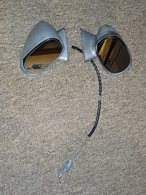

Happy couple.
20230603_191832 by Ben, on Flickr
20230603_191947 by Ben, on Flickr
20230603_191958 by Ben, on Flickr
