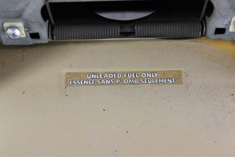

Maxthe222
  • Posts: 951
Re: 77 S. E. help
« Reply #11 on: March 06, 2023, 06:05:54 PM »
Bonjour!
Y88 unleaded fuel decal French Canadian by Ben, on Flickr
Interesting.... I don't think it looked like that, it was a single line and just in French, i'll have to try find another example. Maybe they were a different format for 1979  (Z49 Y88 :shock:)
